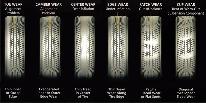

    I don’t recall my stock tires wearing like that though, nor when I got larger KO2’s. Here is something I came across:

    thanks. Its hard to explain and people probably don't notice. the edges just seem to show the wear first. Makes sense since they see all the action on turns. Unless you really looked at the edges you might not have noticed. They just aren't as "crisp" or sharp edged as the rears. Could just be my OCD. And also probably the slight positive camber. By that chart though, it would seem toe. Just had an alignment though and numbers were good.
