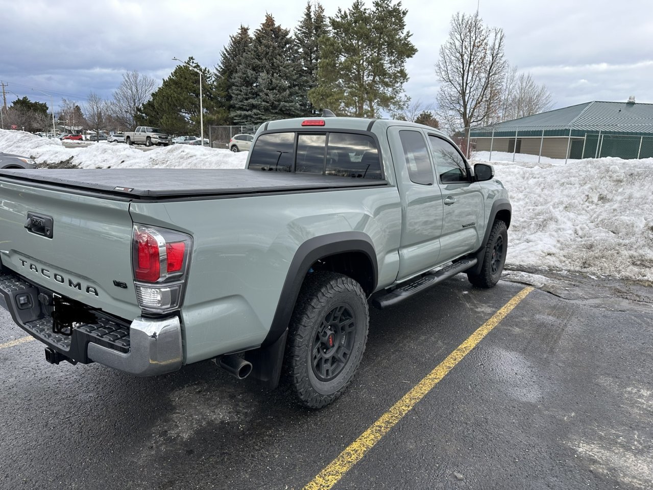

    First world dilemma here…Looking for some technical advice and personal experience.
    I currently have 265 70r17 trd 4Runner sema wheels wrapped in c load range BFG KO2. The combo weighs 70.72 (as far as I can tell) per corner.
    I am debating getting new wheels (which are lighter at 18.13 lbs) and running a heavier and more durable 265 70 r16 e load range KO2 instead, for a total weight of 68.42 lbs per corner.
    My question is: will I see an increase in mpg or acceleration going back down to stock tire size and slightly dropping the weight per corner? Or will it ride like a dump truck and be accelerate just the same?
    And for anyone with Load range e BFG KO2 in stock size(265 70 r16), how is the ride?
    Thanks in advance!
    *pic for attention.
