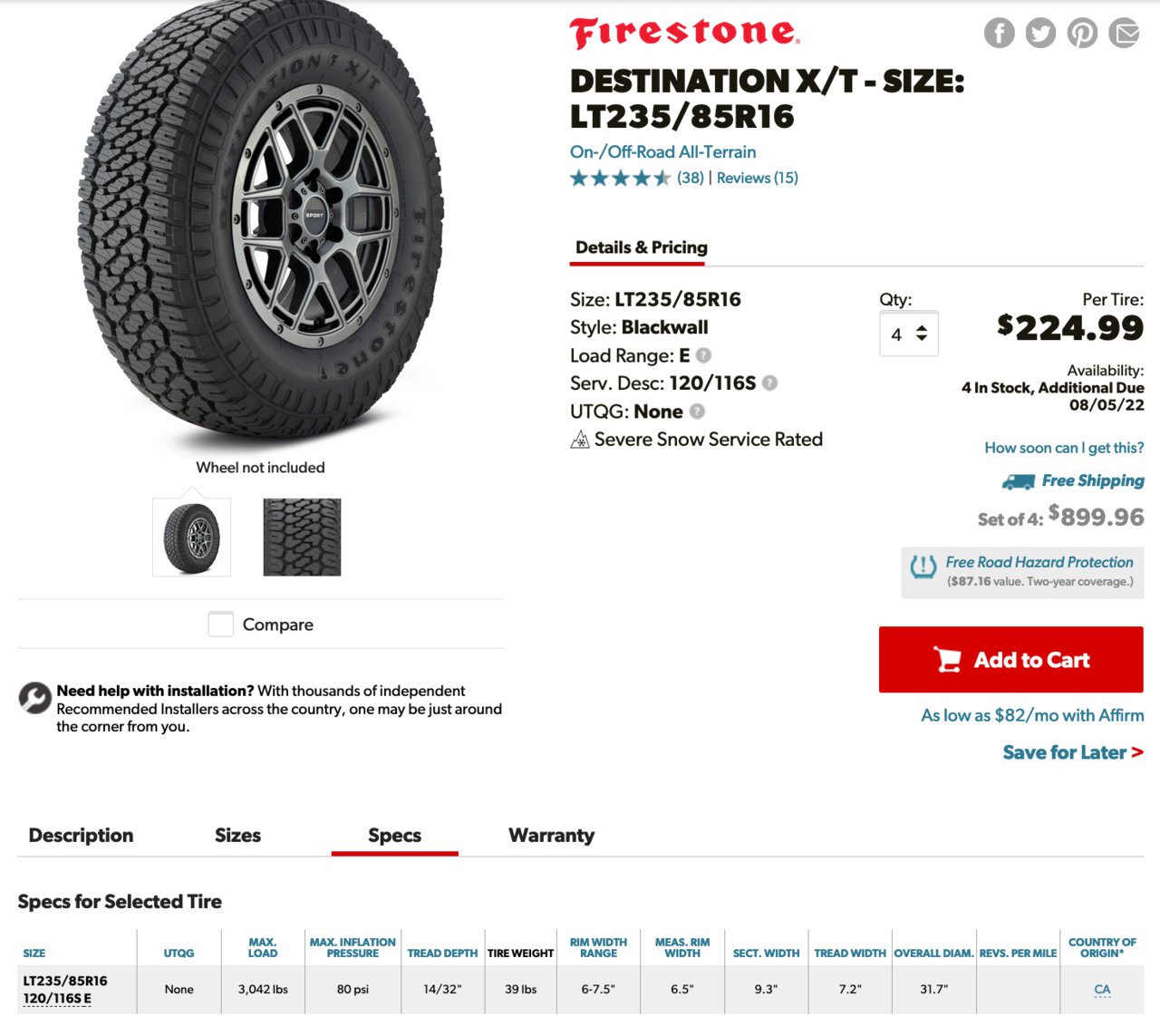

    Are you sure? That is a 10ply E load tire.

    Looks like it

    Yes, the XT version, not the AT you originally posted.
