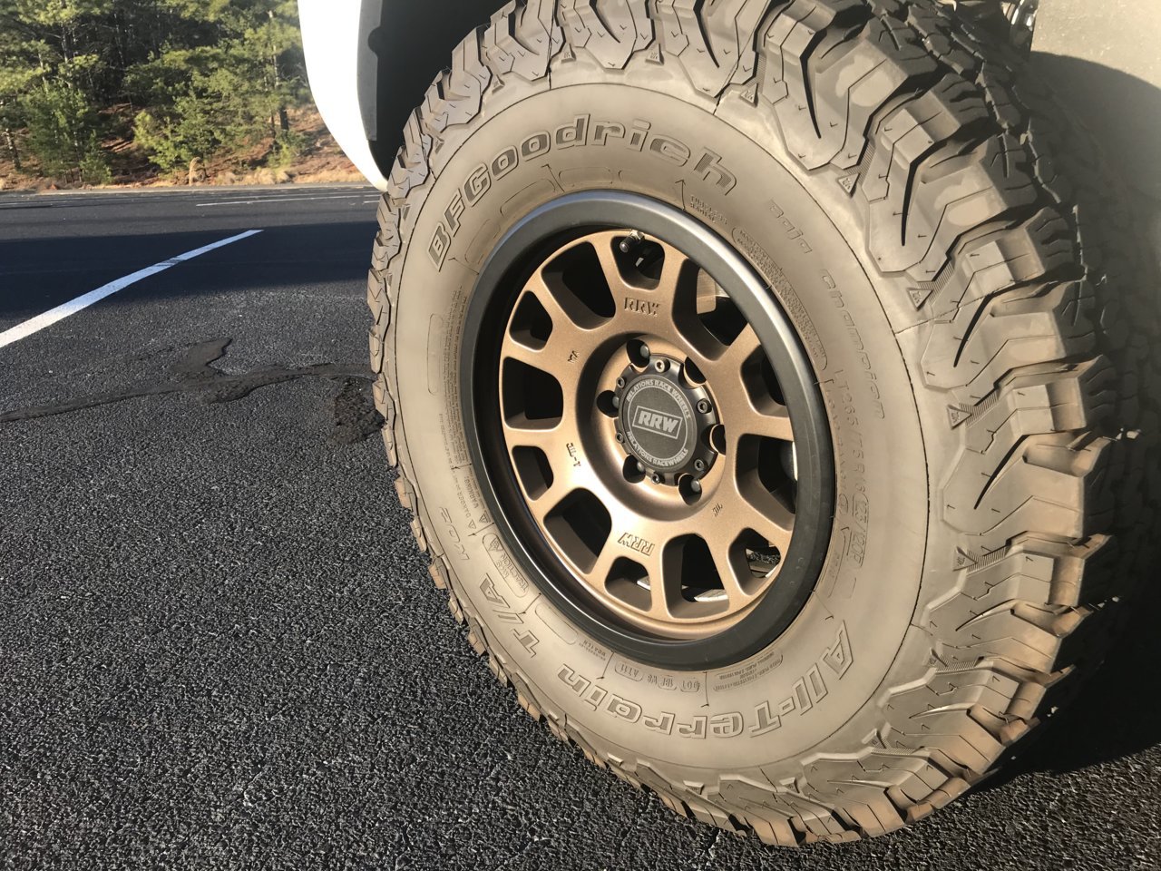

    I like my 265/75/16 KO2s. They are okay for highway use and they are good in dirt and snow. Rain is debatable and there seems to be a lot of tire slippage on wet roads.

    The wheels I have are the RRW RR5-S 16x8 -12 offset in Matte Bronze. It’s a very uncommon wheel but they look great.
    Looks gold in the sun and almost black in the shade which is nice.

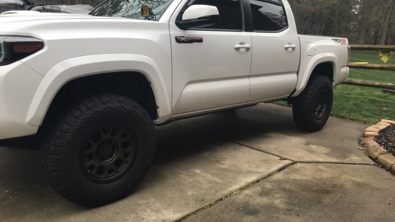

    Just save some coin and keep your stock wheels for DD use and pick up some stock steelies for dirt cheap. Found a set locally for $50. Hell, there's a guy on the "pay it forward" thread giving away some.
    Throw on some 265/75 snow tires and call it a day.
    That's what I did for my Sport. I just run them when I need them.
