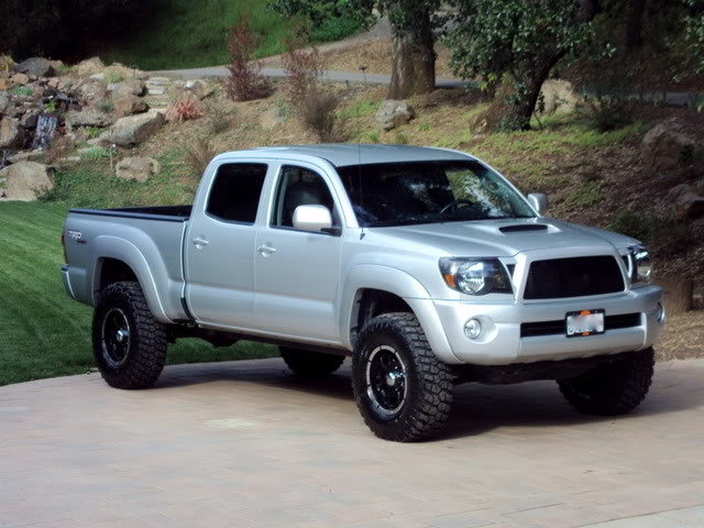

    here's mine!!!!!! best truck i have ever owned.....

    hay man i have the same truck, urs look sick!! deff is the best truck ever!...what kit do u have an do u have any prob with rubbing? i went to 4 wheel parts, i putting a 2.5 in leveling kit with 285/18, they said there will be no prop with rubbing, hewever after reading around that sounds like its deff not the case??

    I think your tacoma looks awesome. What did you do to lift it, or do you have a leveling kit and also how many inches is the lift kit or leveling kit? Can you tell me what size tires and wheels you have and what brand they are? Do you have any rubbing issues?
