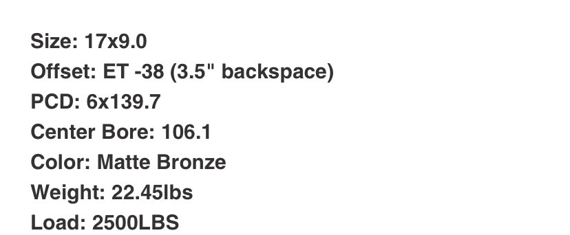

  16. Dec 25, 2021 at 6:03 PM
    #16
    Max Friyuk
    Max Friyuk [OP] Active Member
    Dec 25, 2021
    #385479
    42
    2021 army green Tacoma
    Stock

    That particular wheel is going to cause you a headache. I would try to stay with something 8" wide and maybe 0 offset or up to -10

    Holy shit, that's like 2.5 inches! I have a 0 offset on 285/70R17 and they poke but that level offset is going to require A LOT of trimming.

    It’s not that the less offset is better.
    It’s that moving down from the factory +25 offset helps in getting the wheel away from the upper control arm, however it’s you don’t want to go too low with the offset into the negatives because then you have all new problems (that are harder to deal with).
    The ideal offset is somewhere between 0 and -12 most people would say. If I were you I’d cancel and do more research before buying. This seems like it’s going to end up being a long road of headaches getting the wheels to fit.
    If you stay with -38 on a 9” wheel, You 100% will need to have someone grind the cab mount and weld a new plate on at the very least.
