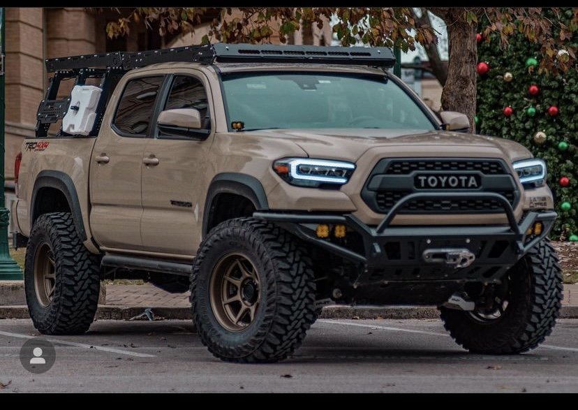

    C90F27E9-5750-40E2-8030-0EF8291D73D7.jpg Looks like he is running same set up. Just with 35inch tires. Yotaloca on insta.

    I’m running the exact wheel. I have a trd pro with the Westcott designs lift. You will need a BMC. Make sure it’s on the more aggressive side so have them trim as much as possible. The viper cut is not really needed but it’s best for more clearance.

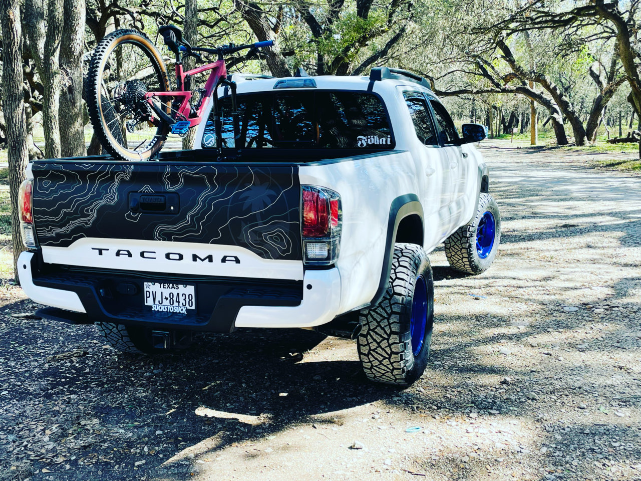

    Barricade HD rear bumper, Cali-raised smoked rear LED lights, Black Rhino (Chamber) black 17x8.5, 0 offset, 4.75 backspace wheels, Toyo Open County AT III 275x70R17
    [/QUOTE]
    Love that tailgate wrap!
