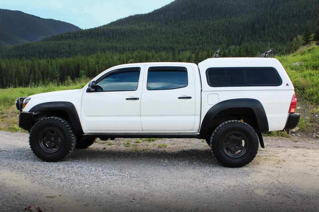

    While planning my build i came to a stand still at tires and wheels. i'll be running OME dakar's in the rear and OME 885's in the front with the 13mm spacer and LR UCA's OME shocks front/rear. So i should have 3-3.5 inches of lift for my DCSB TRD sport automatic V6. Im not afraid to trim what needs to be trimmed or cut to clear tires. It's my DD and will 'maybe' see dirt three times a year.. lots of snow in the winter though. I called a million wheel companies today to find the lightest set up possible. I'd really like to NOT have to regear
    What i think would look the best.
    - Mickey Thompson classic locks 16x8 4in BS.. Black with red ring - 27lbs
    - Goodyear Dura trac's 305/70r16 63.5lbs
    - 90.5lbs total
    The middle Ground
    - Raceline Renegade 6 16x8 4.5in BS black - 21lbs
    - 285/75/16 goodyear dura tracs 55lbs
    - 76lbs total
    The best for fuel/power/mpg (maybe traction too even though i like dura tracs tread pattern way more)
    - 255/85/16 Cooper ST's 49lbs (33.4 x 10.2 = lower rolling resistance)
    - 70lbs total
    any suggestions? how much of an impact does Rotational weight have on power/mpg/stopping/handling?

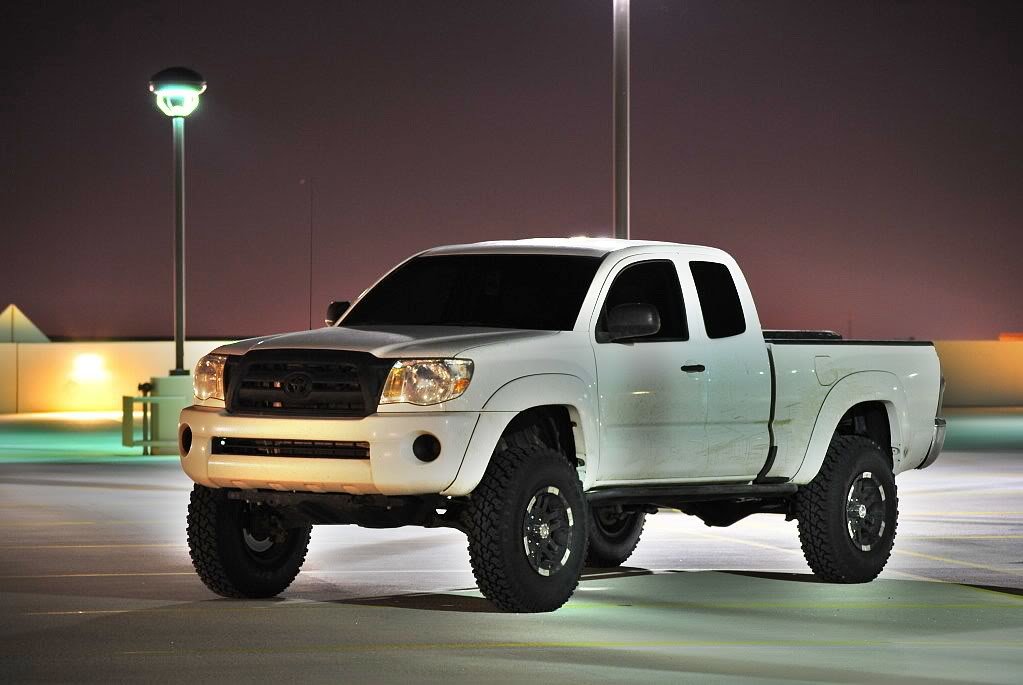

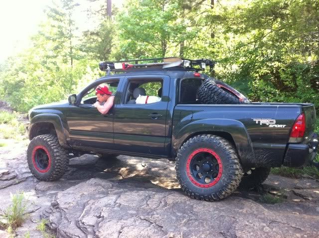

    pics.
    Renegade 6 wheels
    Classic locks black with red ring
    305/70/r16 duratracs on 16x8's
    255/85/16 cooper st's
    thanks to everyone i stole pictures from :)
    EDIT. new plan is to use SCS F-5 Wheels... come in at 19lbs a piece. So the SCS F-5 with cooper ST 255/85r16 will be 68lbs. . Dont think i'll be able to beat that.

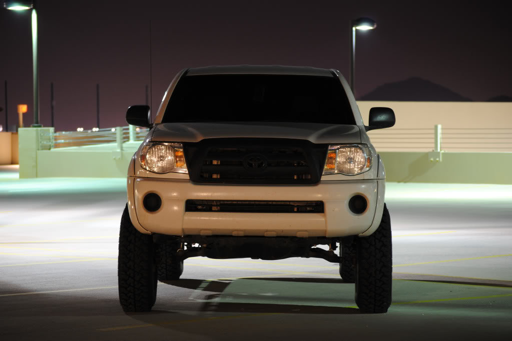

    Um someone can correct me if I'm wrong but 885s probably won't give you 3.5" of lift.
    Also, with 3" and 33s you will have to do some trimming along with a possible cab mount chop.
    Are you planning on running stock shocks..?
    Btw I'm pretty sure that white truck is running a spindle lift.

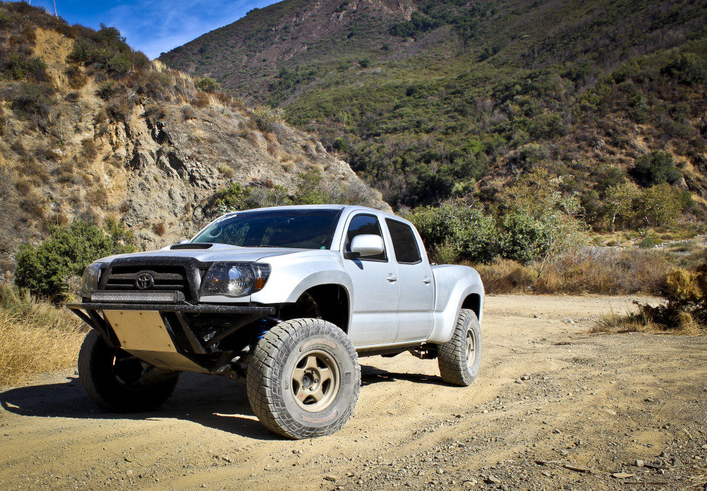

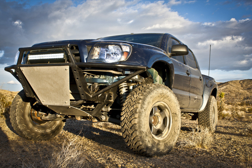

    We just launched our line this past summer so we're still new:D. Here's a few samples on the 2nd gen Tacoma. Feel free to PM if you want a quote or have any other questions.
