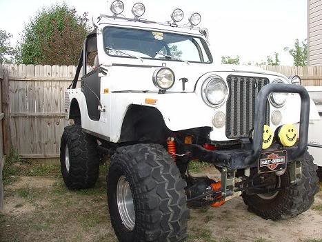

    It's fine....there won't be an issue, just more bulge on the sidewall. Below is my Jeep with a 15.5" wide tire on a 10" wheel (way out of what the manufacturer recommends). Worked fine for years. And on the Taco in my signature is 12.4" wide tire on an 8" wheel.
