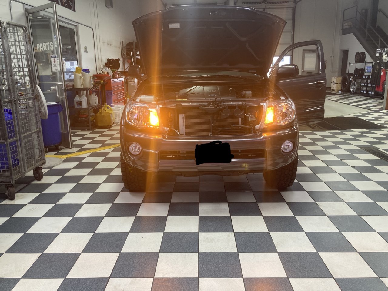

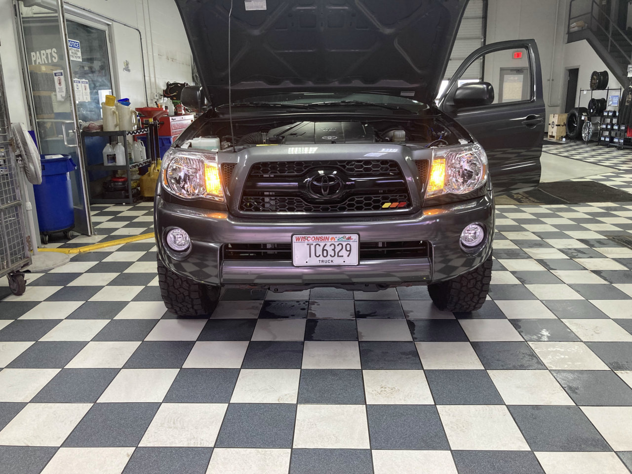

    Couldn't you just upgrade the DRL's? LED's in halogen housings are never ideal. I got a set of LED DRL's from a vendor on here named Jumpers LED's. Bright enough to light the road up amber when just the DRL's are on.They are considerably brighter and were about $60. Lots cheaper than replacing headlights every few months.
    Before:
    After:
    Squirt and steelcity2 like this.
