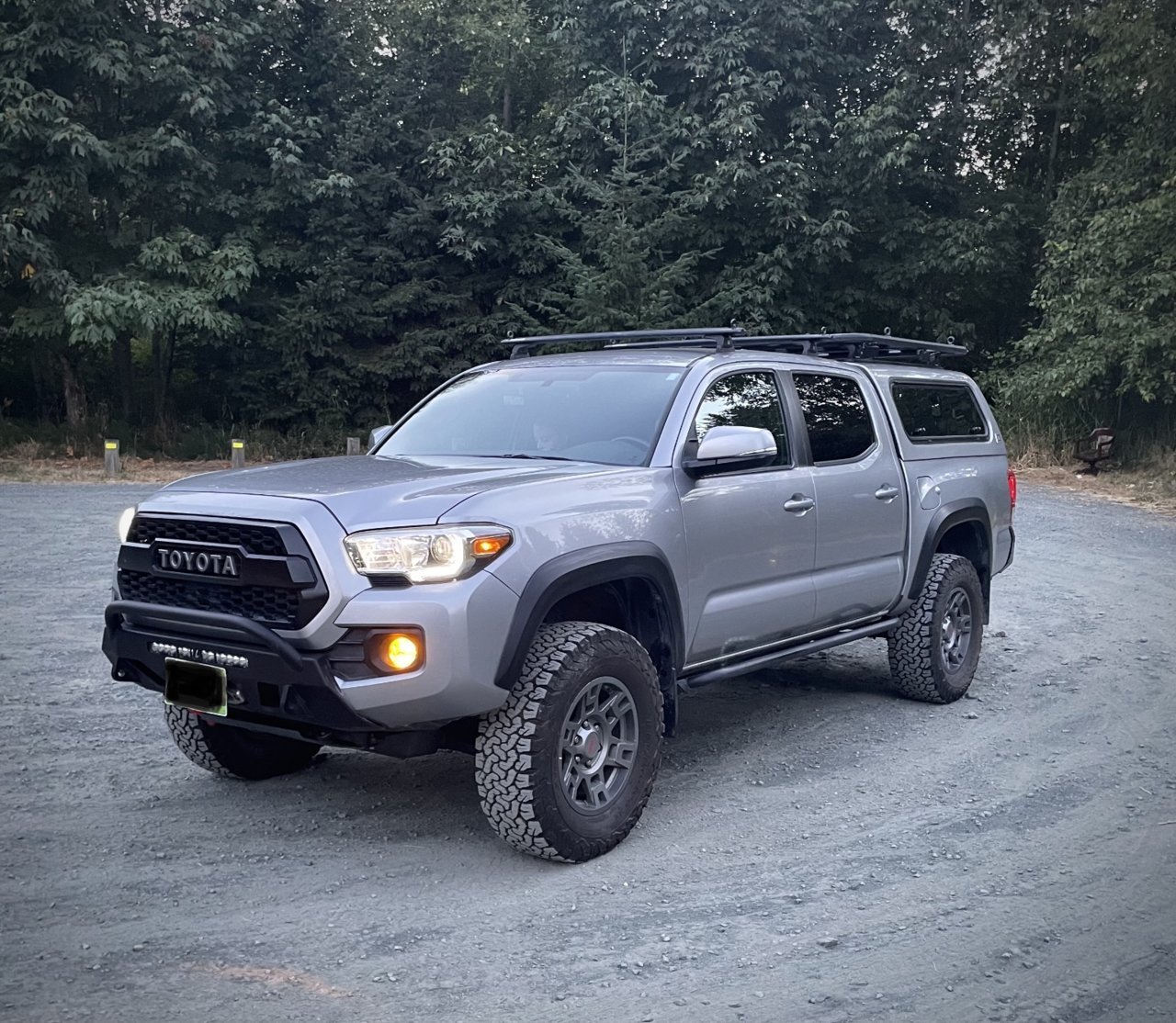

    17” wheels gives you the chance to run 275/70/17, which is the unicorn size. The very largest diameter, non-rubbing, non-pizzacutter tire you can run on these trucks with no rubbing. They also are still a proper mounting width for a 7” wide Toyota rim.

    I have 275/70/17 K02’s on my truck, with factory mudflaps, and zero rubbing at full flex.
    The key with this size is to run the narrow 7” Toyota OEM wheels, like the 4Runner pro wheels. Also, the K02s always run a little smaller than other tire makes.
    With wider wheels it may be a problem for sure, but not with these wheels, and the K02 275/70/17’s

    Dang dude those are some tall ass tires. How much chopping/trimming/banging did you do to stuff 73's on yer 3rd gen??

    Are you lifted? Unrelated, those gunmetal wheels look slick.

    thanks. Toyota makes great looking wheels.
    I have under 2” of lift all round on Billstein 5100s and an addaleaf.
    The lift was not installed to prevent rubbing, just to give me more clearance from the ground. The tires don’t rub even when fully stuffed and turning.
    No wheel spacers, no CMC, factory mudflaps.
