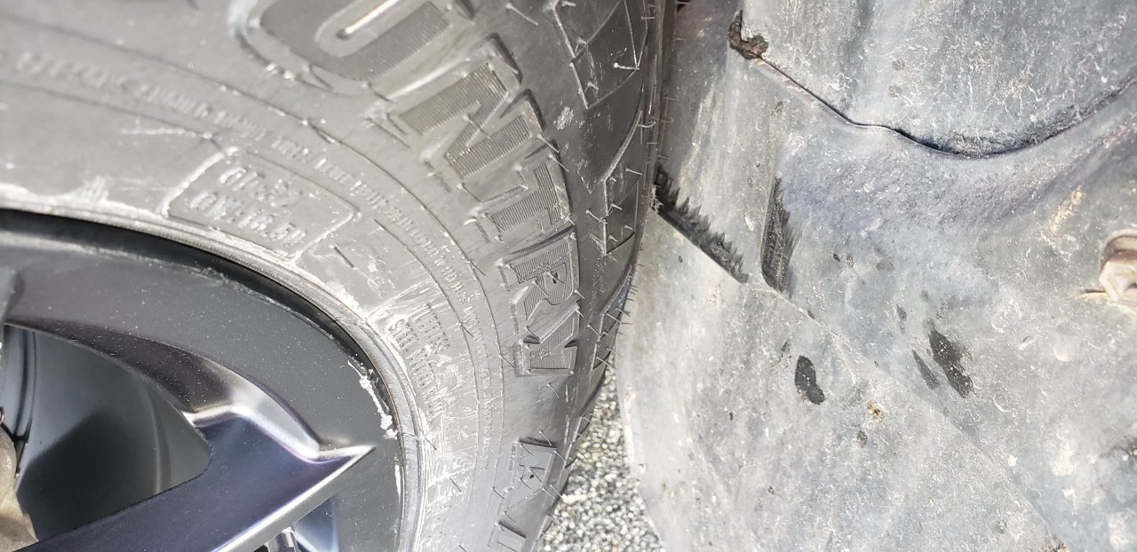

    Largest you can fit with guaranteed no rubbing is stock 265/70R16's.
    Anything larger or wider runs the risk of rubbing somewhere. I just put 265/70R17's on my truck with a +5 offset 17×8 wheel and they rubbed on the mud flaps. That is with a 1.8" lift and aftermarket control arms.
