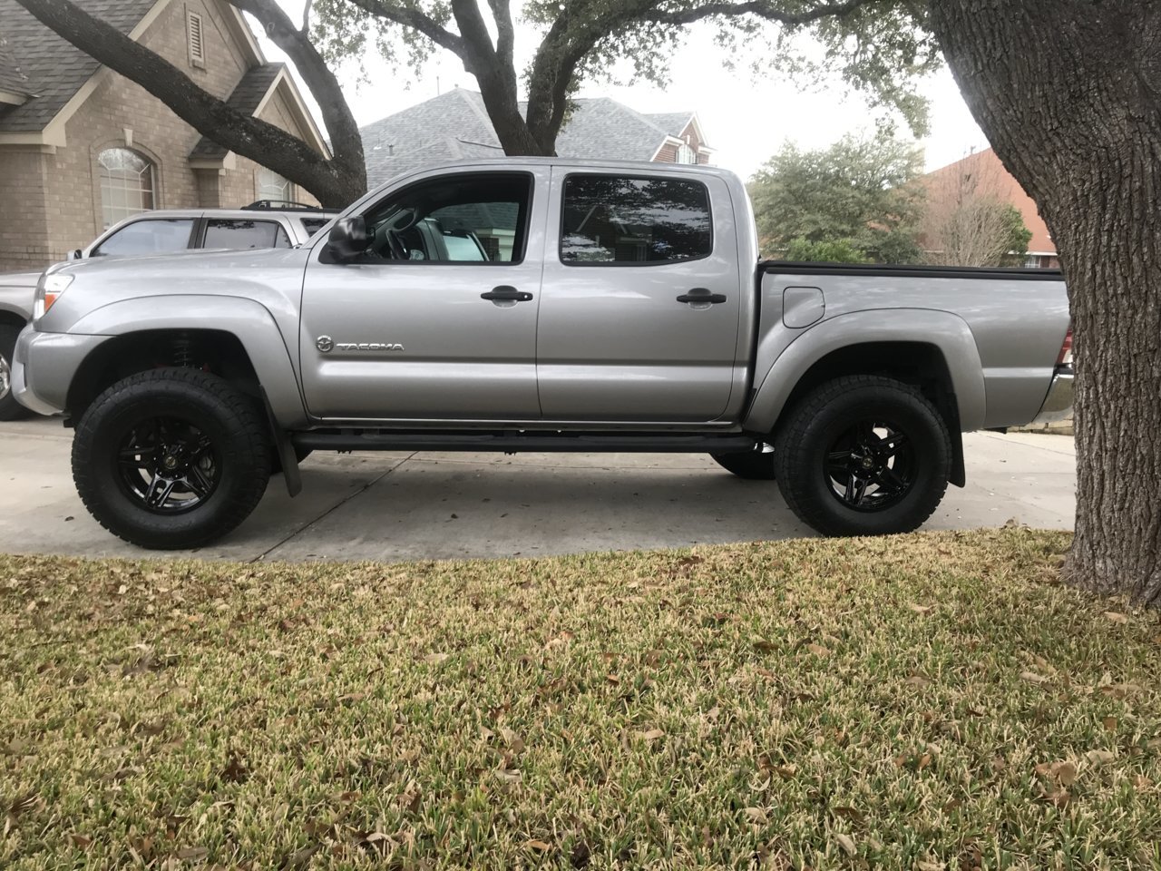

    3” 285/70/17 on 17x8.5 -10 wheels. Jba ucas. Caster at 4* 4F298C8A-337D-4CC2-9E59-12D4E2A52269.jpg

    Thanks. Trucks look great!
