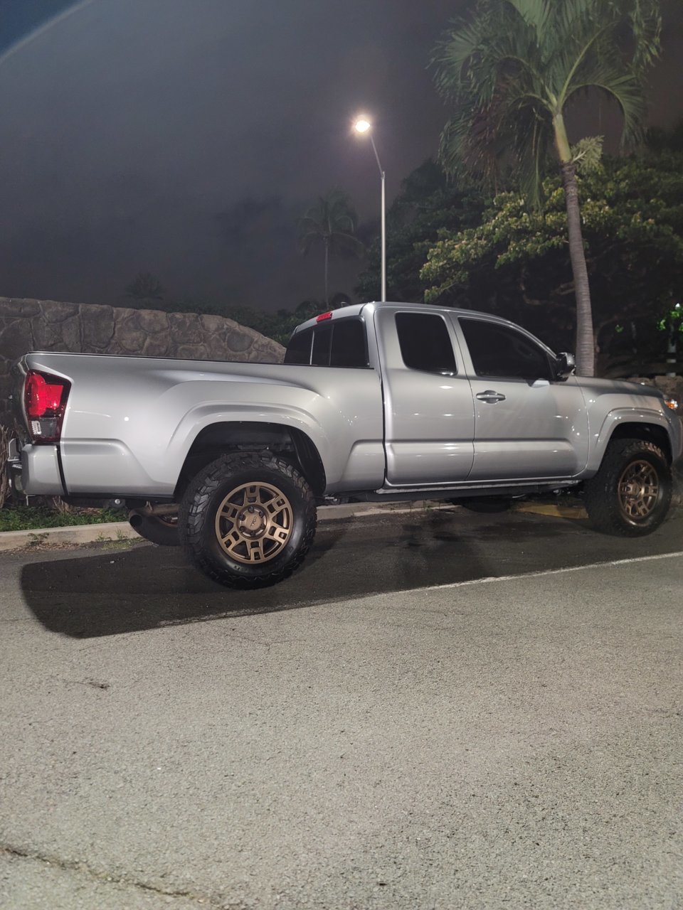

    Have 2021 access cab sr with the trd pro rims and k2 tires. Did it raise my truck a inch? Everyone say it look higher??

    I have no idea what your ride height is looking at your picture. Get out your tape measure, measure the distance between the center of your hub and fender flare, and report back. Stock is about 21” in front and 22” in the rear with a slight lean towards the driver side.

    Says it higher by 1 inch and a 1/8

    those are common tire upgrade sizes for Tacoma owners. Looks like your wheels are 17". Did you change the wheel or tire size?

    I/2" taller per your upgrade in tire size.
