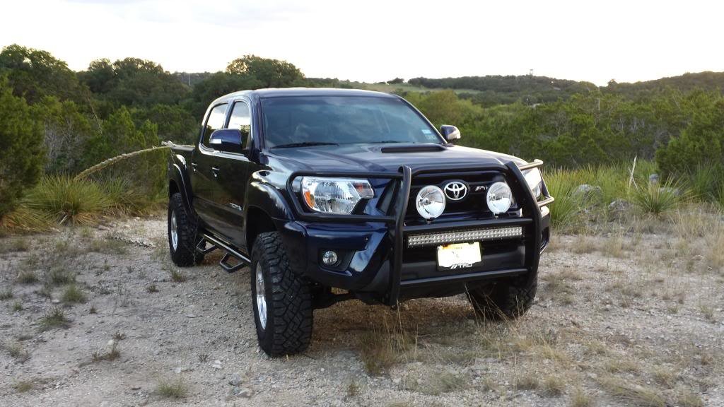

    265/75/16 S/T Maxx 16X8.5 Level 8 Trackers 5100 1.75 HID, LED interior, 3" N-Fab step bars
    My Tacoma came with 17" and I went down to 16"..I think more rubber than wheel looks better on 4X4.
    I have 265/75/16 on 16x8.5" 5100's set at 1.75" I only had to remove the front mud flaps and nothing rubs. I believe with 285 you will have to do some trimming and your gas mileage will take more of hit than 265s.

    ^^^^ looks good
