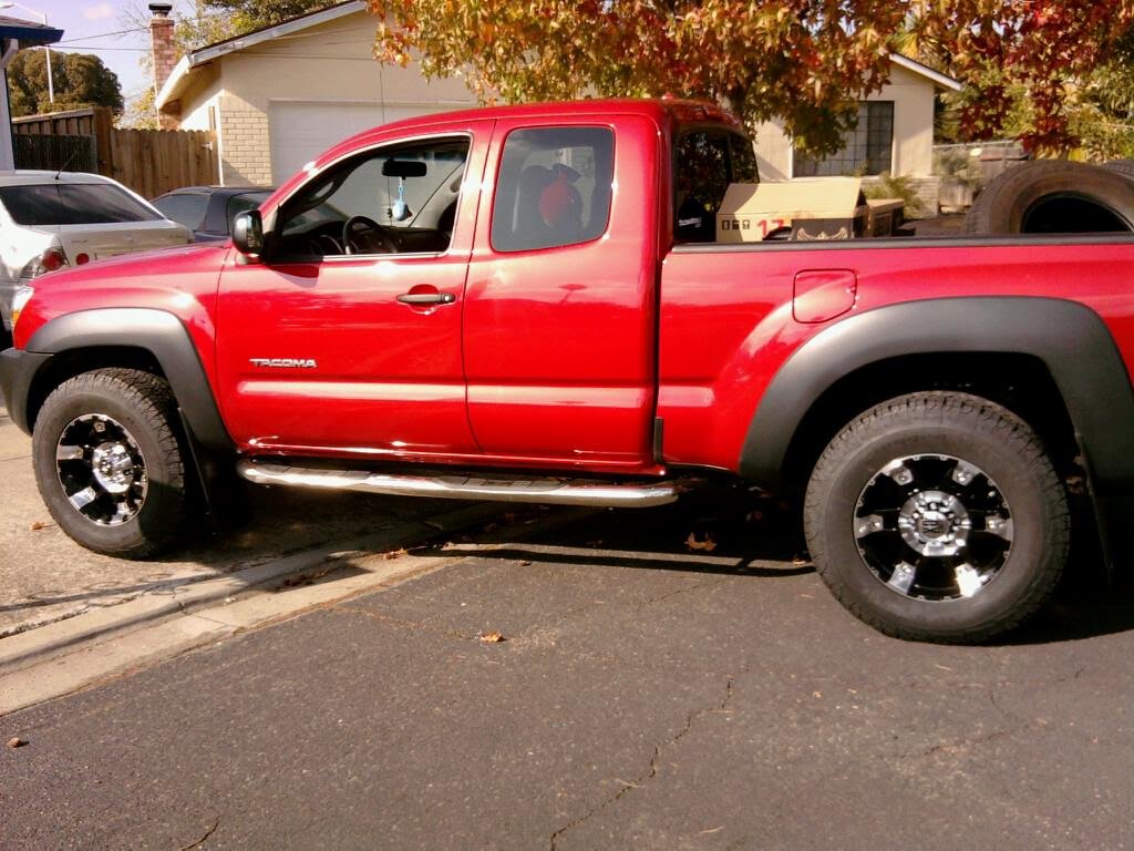

  15. Nov 21, 2011 at 11:11 AM
    wishmytacowaspink
    wishmytacowaspink [OP] Member
    Nov 5, 2011
    #66515
    13
    Candace
    British Columbia
    07 TRD Tacoma Double Cab
    3" Lift Billet Grille BFG All Terrains 285/70/17 XD Spy 17" wheels
    All done....for now.
  16. Nov 21, 2011 at 11:30 AM
    #16
    babytruck
    babytruck Babytruck, babytruck...I've got a babytruck :)
    May 17, 2011
    #56797
    8,985
    NorCal
    2010 Barcelona AC 4x4 4.0 6spd
    COPYCAT!! Lol! Aren't they much better looking in person? I love yours with the lift. Looks great!

  18. Nov 21, 2011 at 11:49 AM
    #18
    wishmytacowaspink
    Nov 5, 2011
    #66515
    13
    Candace
    British Columbia
    LOL Babytruck!!! Who knew!?!? They are sexy tho right? Must be a girl thing...LOL!!
    They totally look better in person, photos dont do it any justice!!!
    Thanks Memario1214...I'm happy...for now...till the next thing comes along, like steps, fender flares and so on and so on!!!
