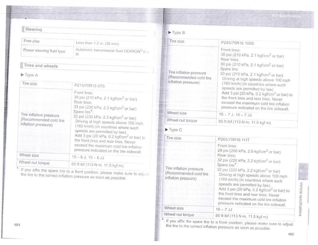

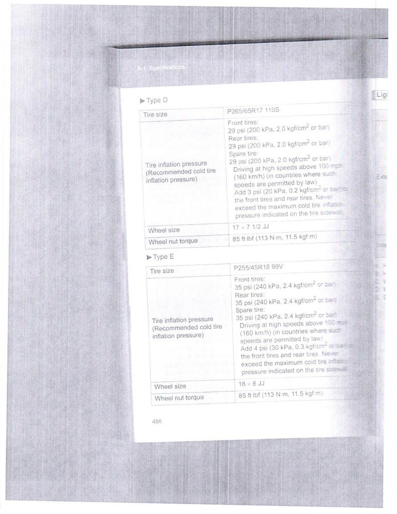

    Ok folks, bear with me. I did search but couldn't come up with a specific answer, not even in the manual. I purchased my truck used and it did not have the factory wheels on it. It has American Racing Trench 16's (16" x 8", +12 Offset, 6x139.7 Bolt Pattern, 78.3mm Hub) per website, with BF Goodrich Rugged Terrain 265/75/R16. So, here is my question. I was going to compare these to factory to see where I was at. In the Owners Manual, it shows rim/tire size by "Type" A, B, C, D, E. See below: Sorry for the huge pics. Anyways, what I can't find is which "Type" I have??? It is a 2010 DCSB TRD OR 4X4. I have found several threads about show your truck with xyz size or whatever but not this. I would assume that I have Type C and not Type B (only 2 choices with 16'' rim) but either way.
    I also found this website: http://www.tacomahq.com/161/original-tacoma-tire-size/ and I believe for 05-11, A, B, C, D, E would go in order of the chart... Any insight is appreciated.

    I think you'd have Type C from the factory. Nice looking truck!

    Absolutely, TRD OR = 265/70/16 on a 16x7 wheel.
    That's what your truck would look like with the original wheels it came with.

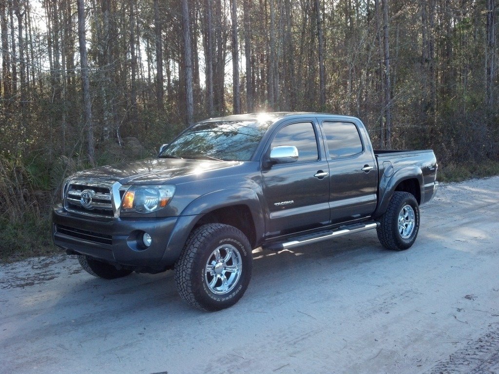

    Gotchya, thanks. I like the factory wheels better than the ones on it. If anyone wants to trade...I would be interested in working something out.

    Thanks, will do. I don't have any close up pictures yet so I will grab some tomorrow when I get to work and there is some daylight. There is nothing wrong with them, I am just not really a chrome rim fan.
