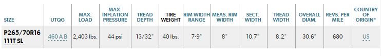

    stock are 16x7 (steel or alum). narrower vs wide depends on the type of terrain you will be traveling in so base it off how you will use it. tall & skinny (255/85R16) seem to be a favorite for their ability to go through some trails and rocks better :notsure:
    see the chart, tread width is just a hair over 8"

    I'm confused, you stated that the stock rim is 16x7 but the chart says rim width is 8". I need clarification because I have stock rims and looking at also buying wrangler duratrac tires but the 285/75/r16 size. And those recommenda rim width of 7.5-9 so I don't want to get them if the rim is only 7"

    first, welcome to the 1st Gen section :)
    second, recommended doesn't mean necessary.
    and yes your stock rims (steel, or SR5/OR rims) are 16x7, the sport rim is 17x7.5
    I'm not an expert but I'm pretty sure you can still put 285 on 7" rim.
