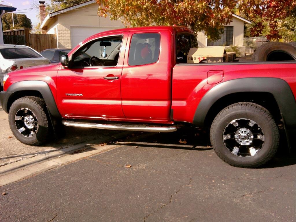

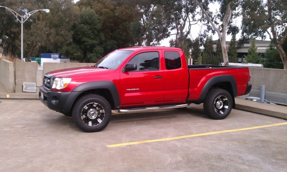

    babytruck
    babytruck Babytruck, babytruck...I've got a babytruck :)
    May 17, 2011
    #56797
    8,985
    NorCal
    2010 Barcelona AC 4x4 4.0 6spd
    I had 265/70/17 and had the same rubbing issues in the same spot, even with removing the flaps. Ended up my tires were too tall, and I went down to 65 (shorter side wall) which was recommended by Toyota. I was able to trade in my tires and not pay any compensation because I had less than 200 miles on them. I didn't want to trim or lift so that was my only choice.
    I don't know lifting it off the front is going to help, I haven't experienced that.
    Compressing tire means if you go over a bump or driveway, the air in the tires will compress and the tire will widen slightly at that moment of impact on the bump. Kind of like taking a long balloon and pressing down on the middle of it, the outsides will swell a bit.
    With 265/70/17
    With 265/65/17
