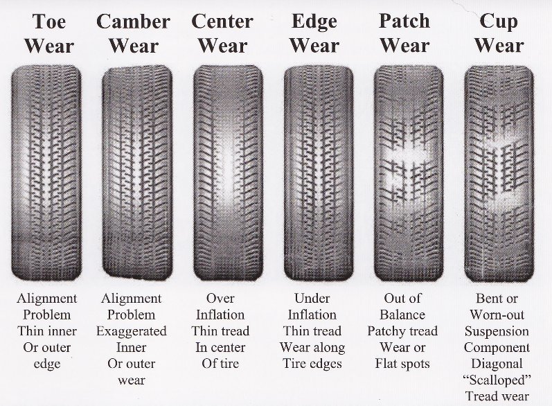

    Best explanation I've ever seen thank you

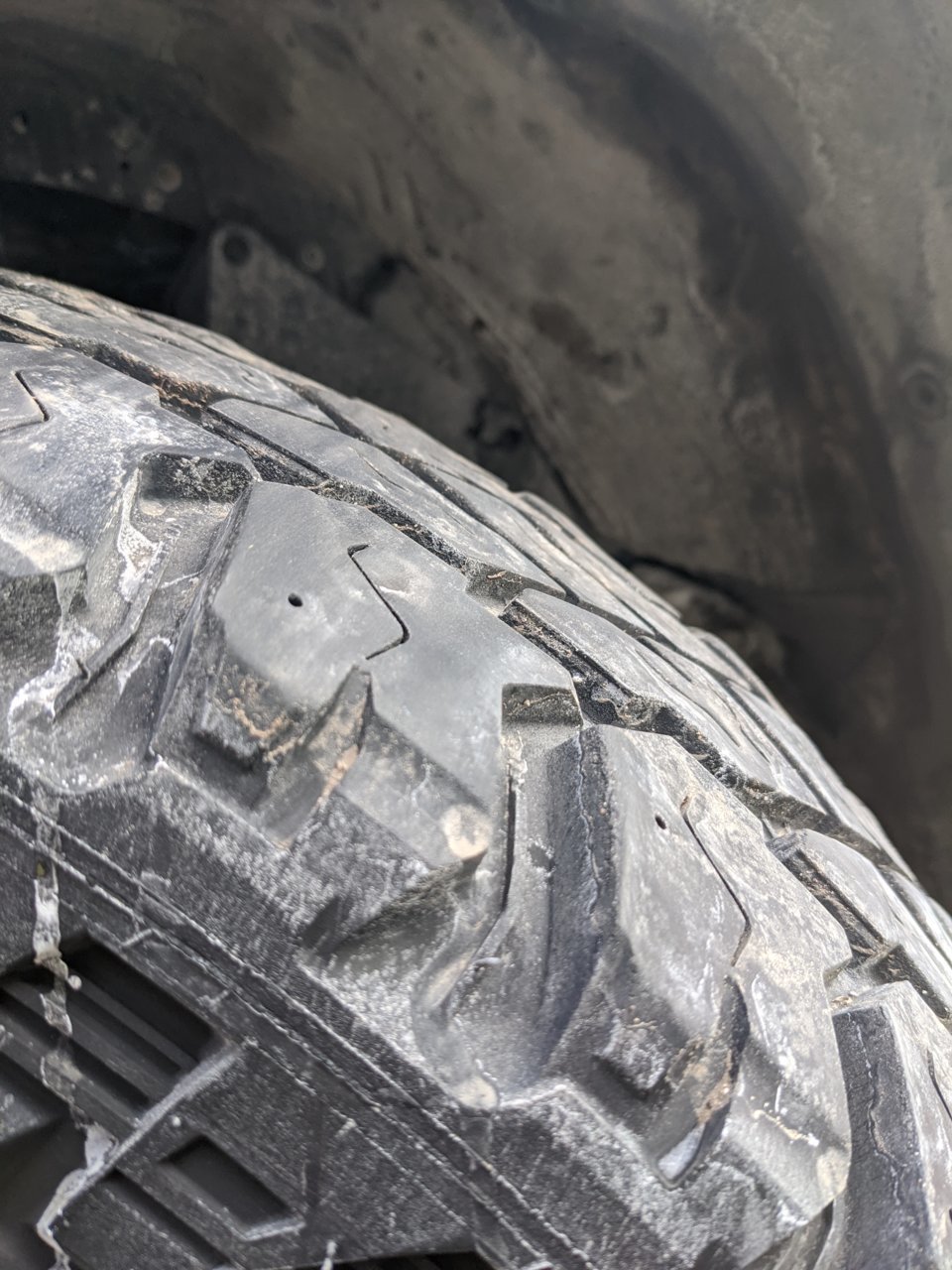

    Hw523
    Hw523 [OP] Well-Known Member
    Nov 13, 2017
    #235861
    57
    2020 Tacoma
    3 of the 4 look like this

    Mark77
    Mark77 Well-Known Member
    Nov 29, 2020
    #348171
    2,613
    Mark
    2021 White TRD Off-road
    Nothing yet
    Honestly, looks like suspension/alignment issue.

    splitbolt
    splitbolt Voodoo Witch Doctor
    Mar 7, 2010
    #32761
    7,858
    NW Arkansas
    2016 TRD OFFROAD DCSB MGM
    See, I would of expected a front view when you said "choppy". All I really see is heel-toe wear.
    What rotation pattern are you using?
    What's the tread depth? They look pretty close to done...

    FWIW, my tire shop says they see more cupping with ST Maxxs than any other tire they offer.
  15. Jan 30, 2022 at 10:27 AM
    #35
    Key-Rei
    Key-Rei Well-Known Member
    Jun 20, 2017
    #221942
    7,863
    Key
    Florida
    2010 TRD Off-Road 6Spd 4x4 209BSM
    Locker anytime Fog Lights anytime Full LED light conversion TRD cat back Rear cat delete Exaust Y reroute away from actuator Alloy Clutch master 2000 4Runner "Dog Leg" shift leaver Marlin shift seats and bushing Rear seat delete Rear diff breather extension Chrome grille swap Debadge Rear seat delete Honda blower motor beefy plug and wire mod Anytime 12v and USB with volt gauge in bed Blue Sea fuse box Hella AND 70's Caddy horns Low profile recessed hex drain plug swaps Alluminum battery strap 7pin relocated Backup cam on anytime Various other creature comfort and personal taste mods.
    FWIW I have Cooper ST Maxx's they're wearing beautifully getting plenty of milage out of them and my alignment is *NOT* in spec.
    When you lift your truck you change the geometry and the factory spec is no longer appropriate and can lead to bad wear issues you need to get an alignment done by a lifted 4x4 specialist.
    I am running 0° toe, 0° camber, +2.25° forward caster.
    33psi front 32psi rear E load 285 75 17 on 3" Fox adjustable coilover lift OME 2nd gen Dakars+ and Archive Garage Hammer Hangers.
    That said OP I'd put money on worn suspension components, when's the last time you did upper and lower ball joints and inner and outer tie rods? How old are your shocks? Have you chalk tested?

    You get those before or after the Good Year acquisition?
    Heard nothing but good things about Coopers before (when I got mine) and a good handful of horror stories since.
