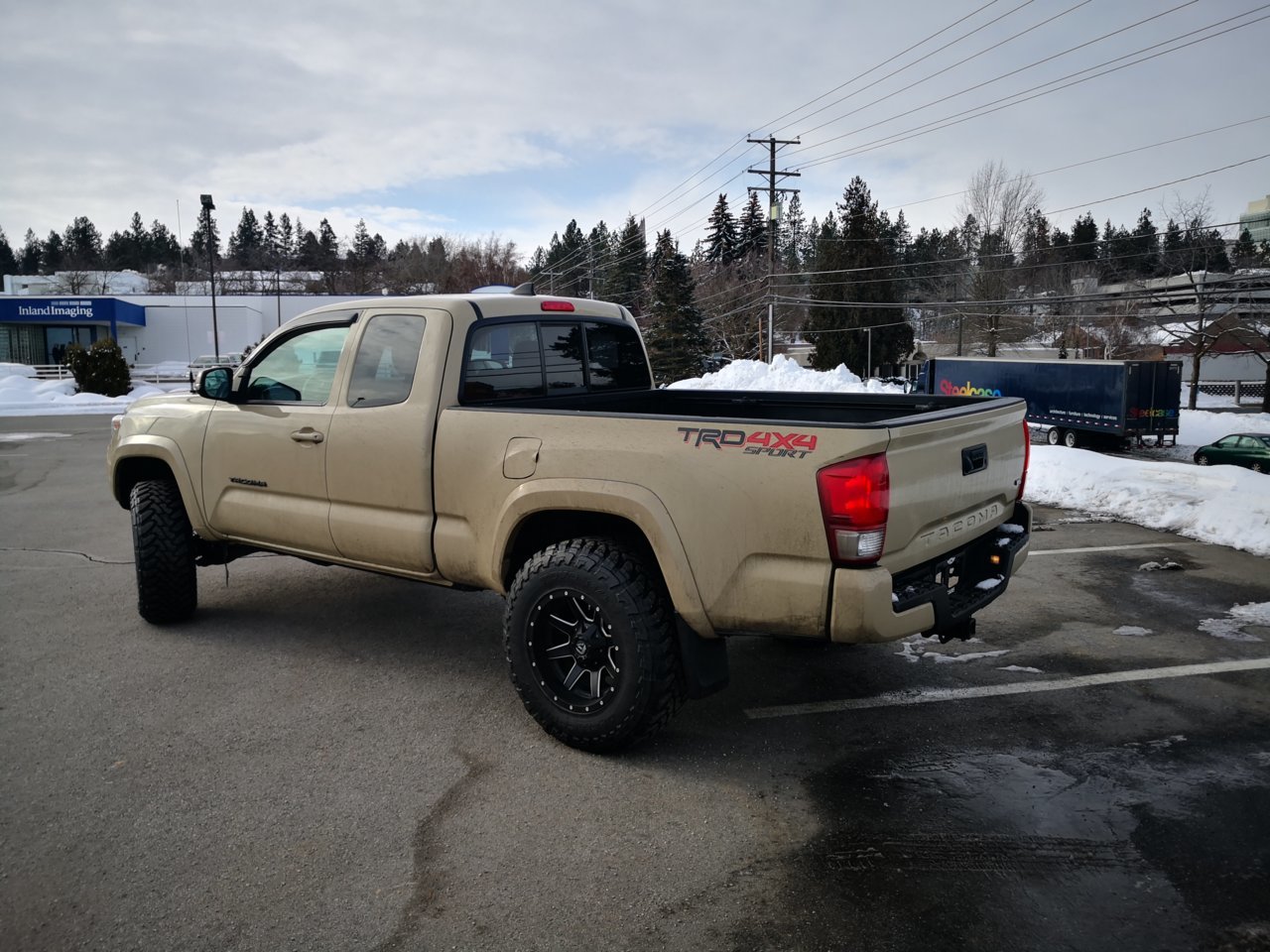

    This is a picture. Fuel lists the maverick d538's as having an offset(in the tacoma bolt battern) either:
    in size 8.5: 20, 25, 32
    In size 9: -12, 13, 14, 20
    in size 10: -24, -12
    I'm only guessing that they are 9 inches.. Fuel is really great about not putting any identifying info except their logo anywhere on the wheel accessible to me right now. I measured across the inside of the wheel from one lip to another and it came out as 12" so that can't be right.. Anyway my best reasonable guess is 9" with -12 offset based on how they stick out. The website also lists BSM (backspacing), or are backspacing and offset interchangeable? Anyway the BSM for 9" -12 offset is 4.5 inches
