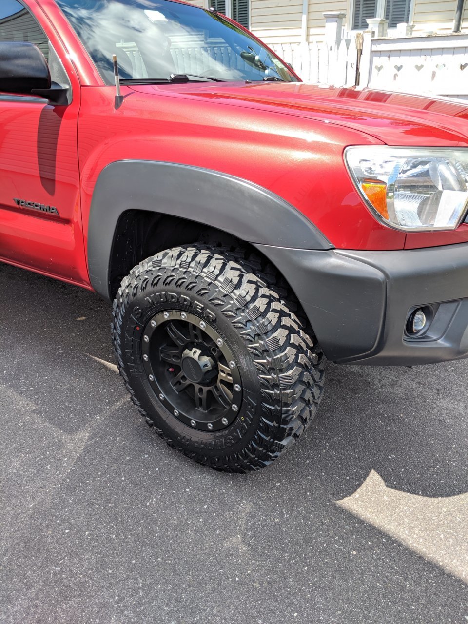

    I ran Hankook DynaPro ATM's on my stock steel wheels for a while...I ran them in 265-75-16 without any issues. I also added a 1/5" spacer to give it a little stance, and only had to do some minor front fender liner trimming. I've since switched wheels (and tires) but I keep the ATM's on my stock steelies for the winter now.
    This is what they looked like on the stock steel wheels, with a 1.5" spacer

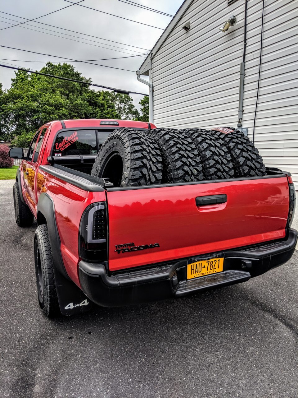

    A 255/85 is a 33" tall tire, whereas a 265/75 is just shy of 32" (Usually 31.8"). The 265/75 is 0.4in wider though, which makes the difference with rubbing or not. I opted for the 265/75 because I wanted a wider tire. Tall and skinny looks weird on these trucks, but that's just my opinion.
    I recently mounted a set of 265/75 Maxxis Buckshot II's to my 16x8 ProComp wheels, and I had to do a far amount of massaging (Pinch weld flattening, cab mount chop) to get them to not rub because of my spacers...but they look titties!
