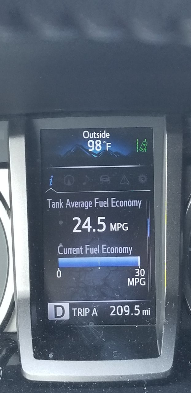

    Switched from the stock Goodyears to Michelin X LT A/S's and am thrilled with the handling and mpg boost. I was averaging about 19 around town and now get over 21. Just came off a highway road trip at 75-80 mph with A/C and pulled down 24.5.
