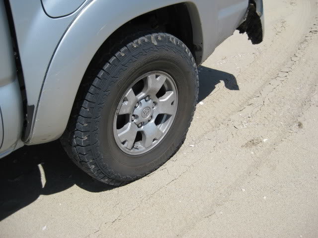

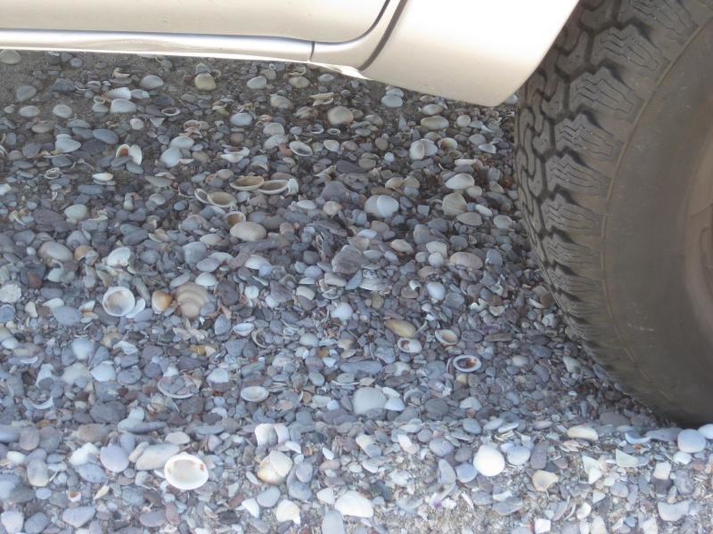

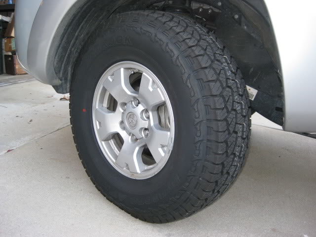

    All 265/75-16, no rub ever:
    Extremely impressed with Hankook DynaPro ATMs in off road and on highway. They performed great in mud, snow, sand, rocks and were quiet on the highway. Mine were the P type and not LT type.
    I am running Pep Boys (made by Cooper) Destiny Dakota AT now, have 20,000 miles on them and no flats yet. They look close to 50% worn. They have done great in sand and quiet on the highway. I have not had them in snow or mud yet.
