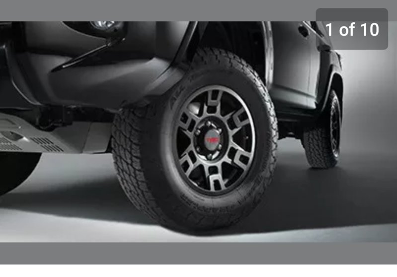

    Hey guys, just got a 2013 tacoma trd sport a couple days ago. Wanting to know what I need to do to be able to stuff 285/70/17 tires under my taco. The wheels will be the sema edition trd wheels.
    On second question is leveling kit or 3 inch lift? I will be doing zero offroading in this thing, as I am building a 72 gmc for fun times. Lol, she will be a streetqueen! Pictures of both with 285's would be awesome! Price between the two?

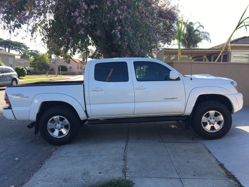

    3" Front lift OME/5100 set at 0, 1/4 spacer on driver side CMC, BFG 285's, SCS ray 10’s -38 offset 1 inch rear block N-Fab steps Bumper Cali Raised LED light bar Cali Raised LED fog lights After market exhaust, and muffler tip Redline hood struts Tacoma Bed-liner mat Tailgate lock Tinted windows 20% HID headlights Short antenna Clazzio Seat covers Joying head unit
    Today's mod! 285's bfg ko2. 3inch bilstein lift. No rubbing!! Only on strong turns and at full lock with my uca. Will spacers fix it and what type and or vendor. Thanks

    I just answered this question in the other thread no ?

    Yessir! I'm reading and some ppl recommend new uca. I saw some at Oreilys but idk if those will be fine

    New UCAs won't keep 285's from rubbing the UCA on stock Sport wheels
