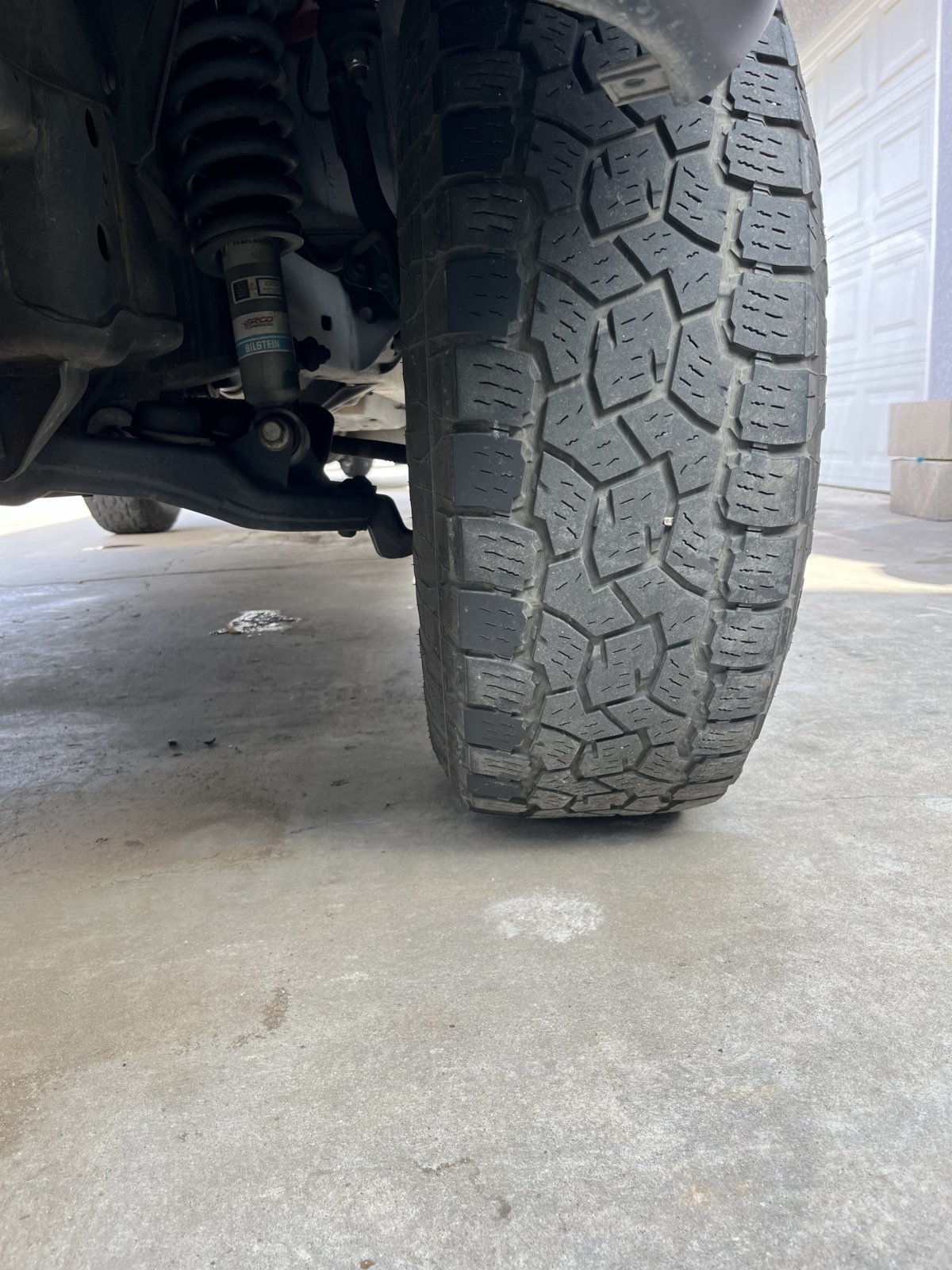

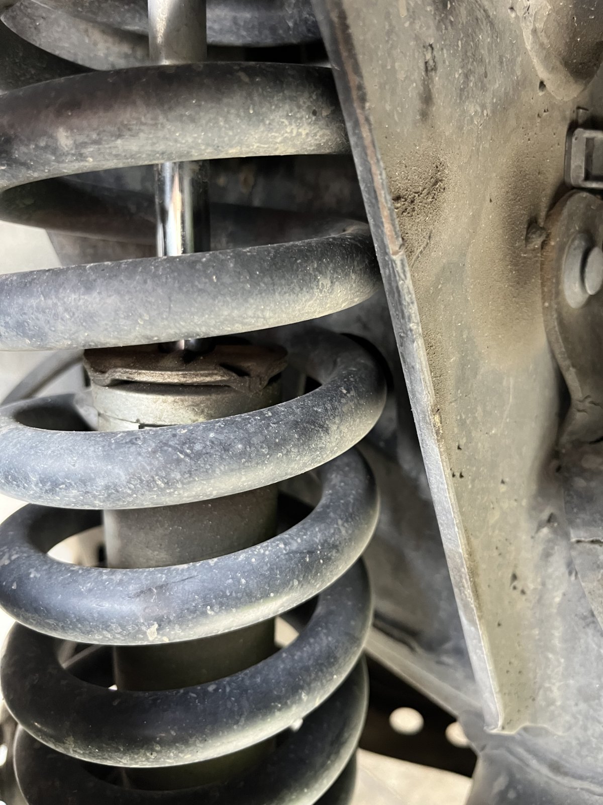

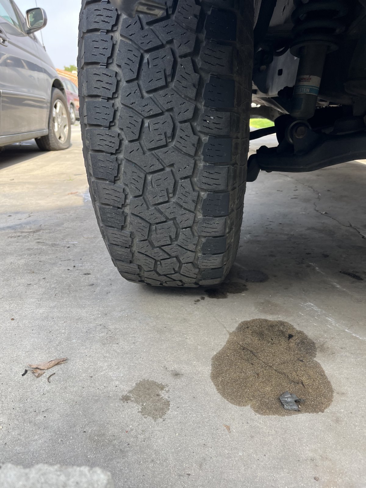

    Update. Still dealing with this coupling :annoyed:bump to 35 psi ran better but now still got coupling issues . No alignment yet front suspension is pretty solid . Took off rear shocks and press then down an got good rebound. Front shocks ℹ haven’t take them off to check .
    rear tires have the same issue

    If everything in your front end is solid and was checked with the suspension loaded, meaning jack/stand under the lower control arm as close to the tire as you can then too much toe. I'd also recommend positive camber for these trucks. They're sensitive to toe.
    I've found 0.02" of positive total toe to have the best tire wear and 0.08" of positive total toe to drive the best. 0.06" of positive toe is my recommendation for the best compromise. If you never hit the highway then closer to 0.02" might be more to your fancy

    Front end is solid running 5100 and 881 with JBA uca’s going to do an alignment next . What about my rear end with solid axle there no adjustment correct ?

    You have an alignment or balance issue, quite possibly both
