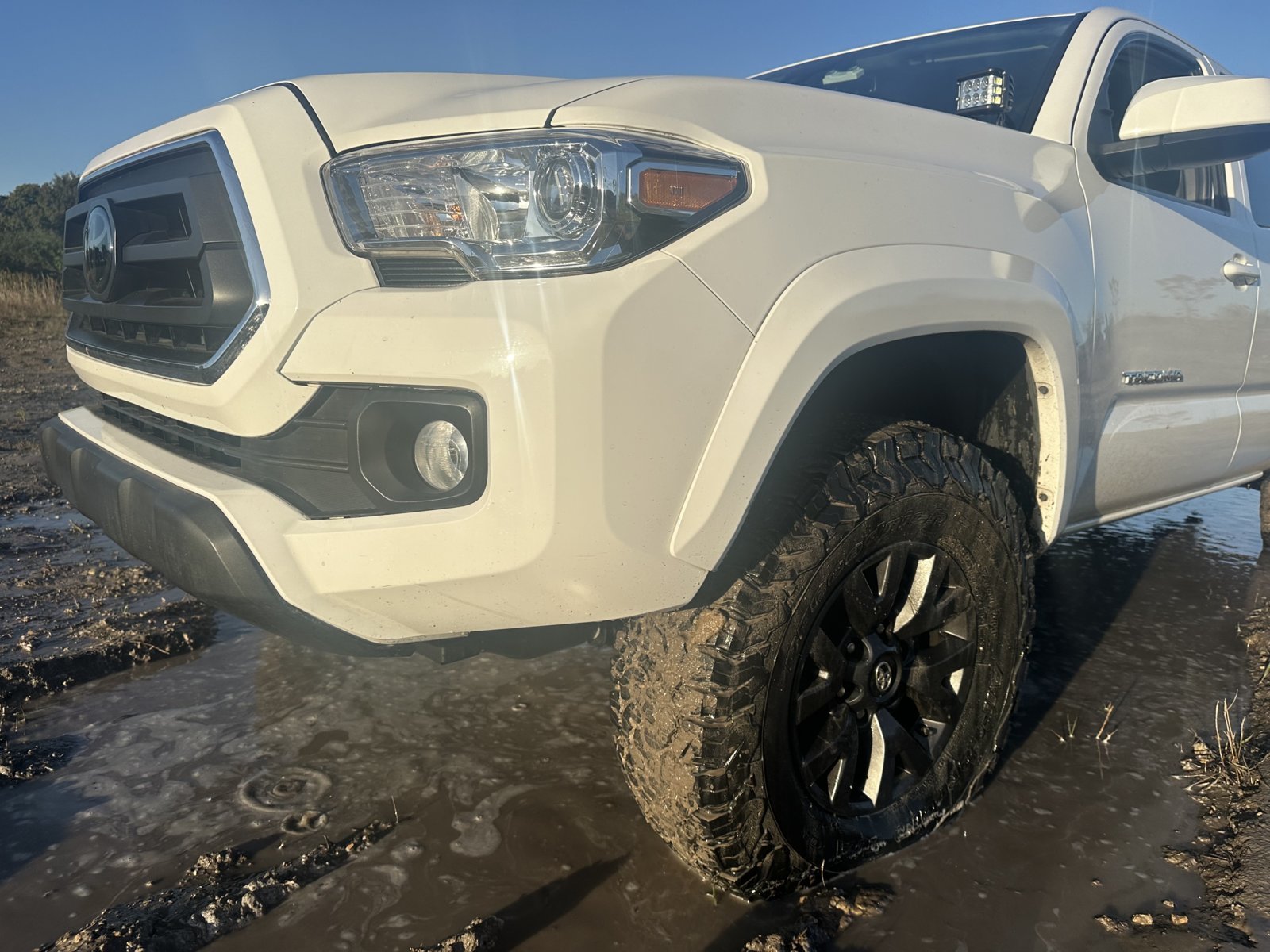

    IMG_7485.jpg My BFG KO2s perform great on road and off road so far with little over 300 miles on them.They don’t make much noise other than the occasional rock pebble getting stuck between the treads and hearing chatter as it rolls. i have 265/75/16 size on stock SR5 wheels. The balancing of the tire took two tries at first and used a lot of weight, but my stock highway tires used lots of weights on the wheel as well so i think it’s just the wheel itself.. at $250 a pop and getting 5 i spent around $1369 with tax from Amazon.

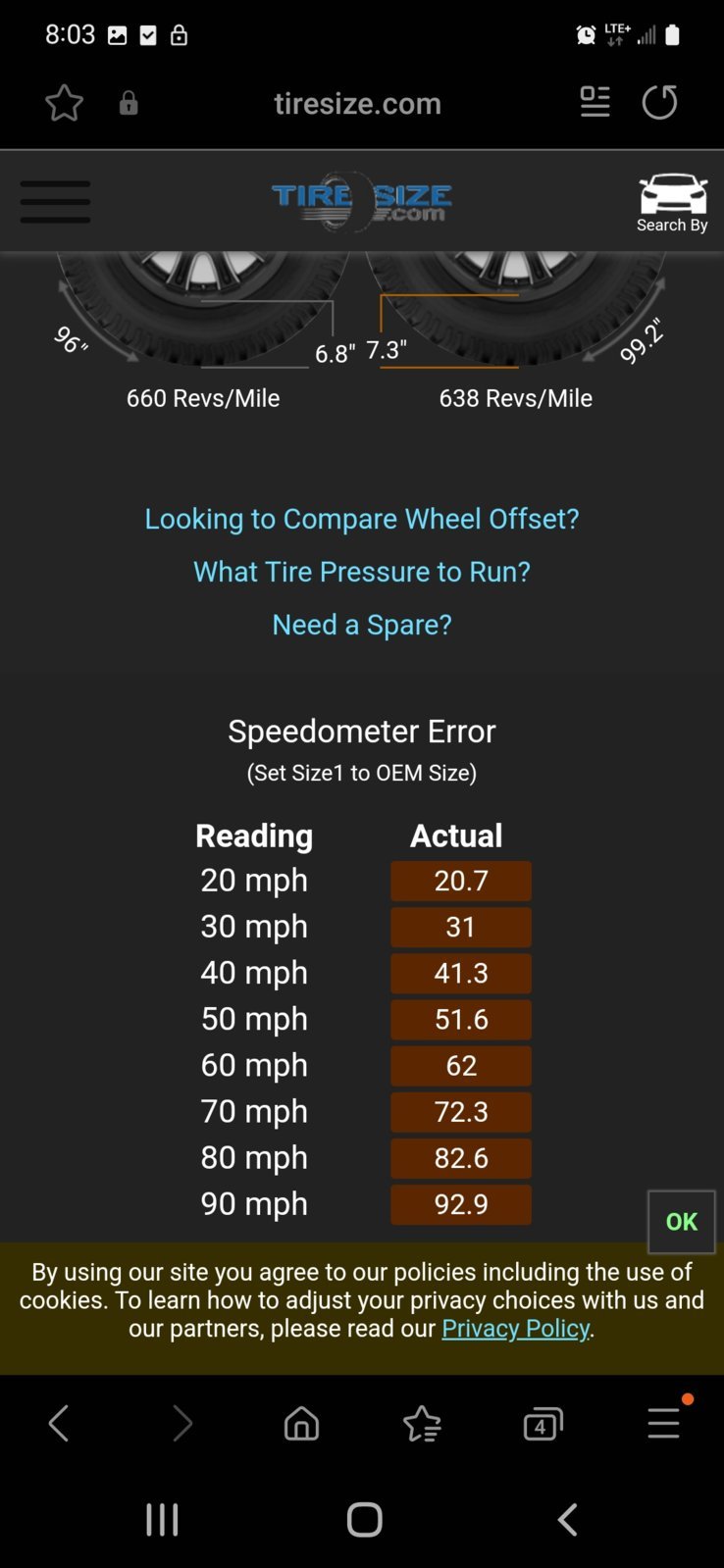

    Do I have to worry about rubbing if I go 265/70/r17? Do you know how much this size of tire will affect the speedometer reading? How about the mpg, will it help or will it lower the mpg?

    Stock wheels you won’t rub. If you have wheels with about 4mm of offset or less like aftermarket wheels then you will hit mud flaps on turns or fenders if you have wide aftermarket wheels like 8”+ combined with negative offset.
    Mpg will probably be about the same, maybe a bit worse on windy or hilly days where the truck works a bit harder because the tires will tax it more in those conditions. It isn’t much difference though.

    With a 0 offset or less generally there's no rubbing concerns if you have stock flaps it might hit that a little bit. It can easily be trimmed or swap to a low pro flap like rokblokz.
    Mpg will take a hit with any AT over stock how much will be determined by tread pattern and weight. Sticking to an SL or P load will keep the tire as light as possible and retain alot more ride quality. The difference won't be drastic but expect to see a small change.

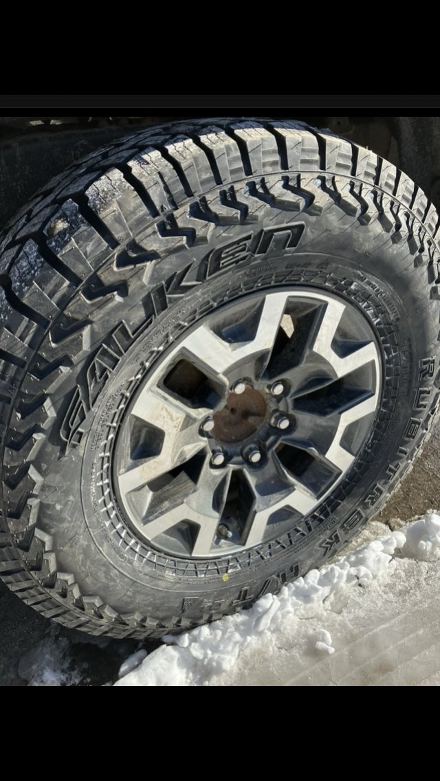

    I’ve ran a set of Wildpeaks on my 2017 sport and then put a set of Rubitreks on it before I sold it. My 2021 Pro now has Rubitreks on it and they’re great. I got mine through Simple Tire with a coupon code back around Black Friday for like $600, no lie. Great tires

    Rubitrek 265/70/16

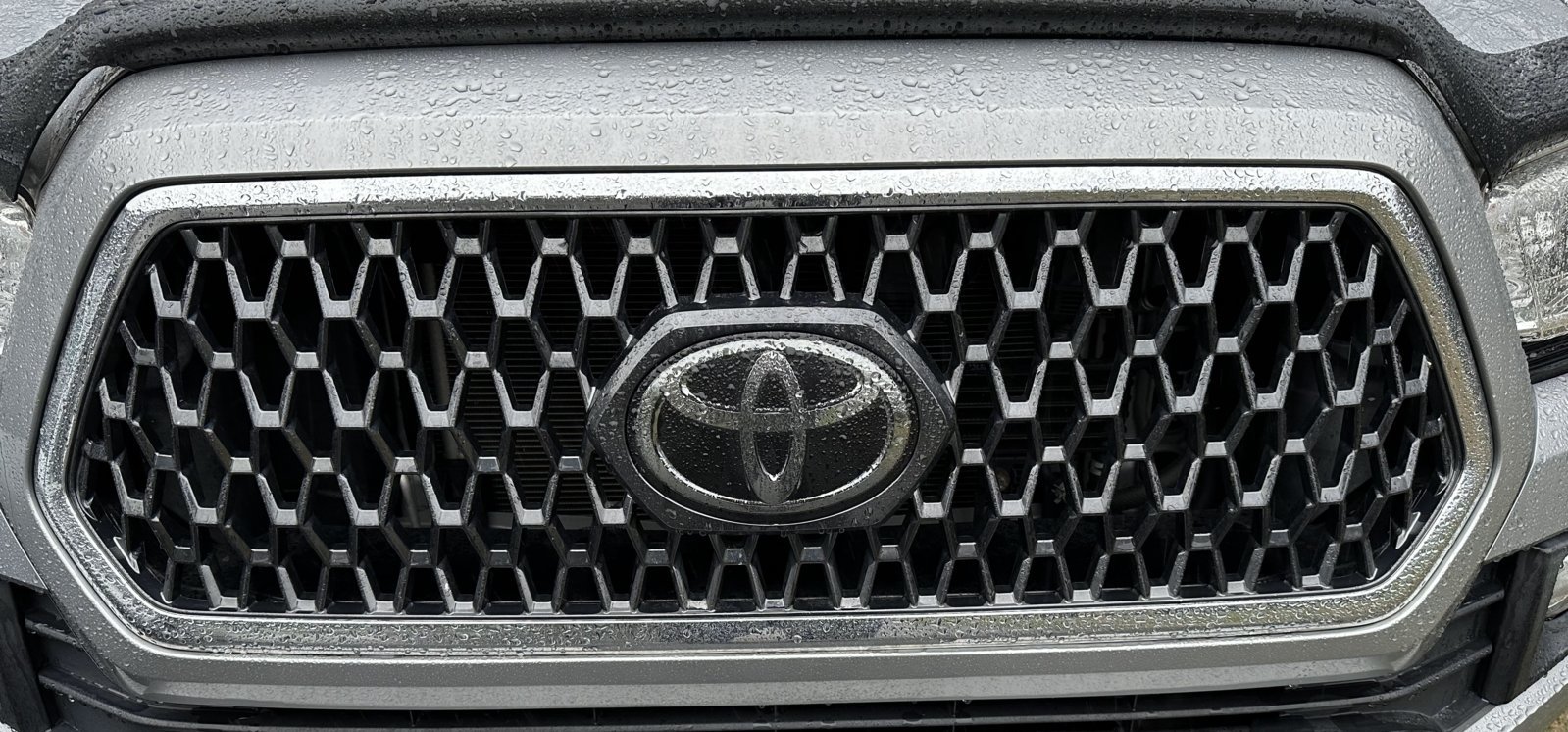

    Different topic, why I am seeing different grille on other Tacoma's. My 3rd gen grille (see thumbnail) is the same as the grille on your truck while the other 3rd gens I am seeing has different grille's with the word Toyota and some have the Toyota Emblem.
