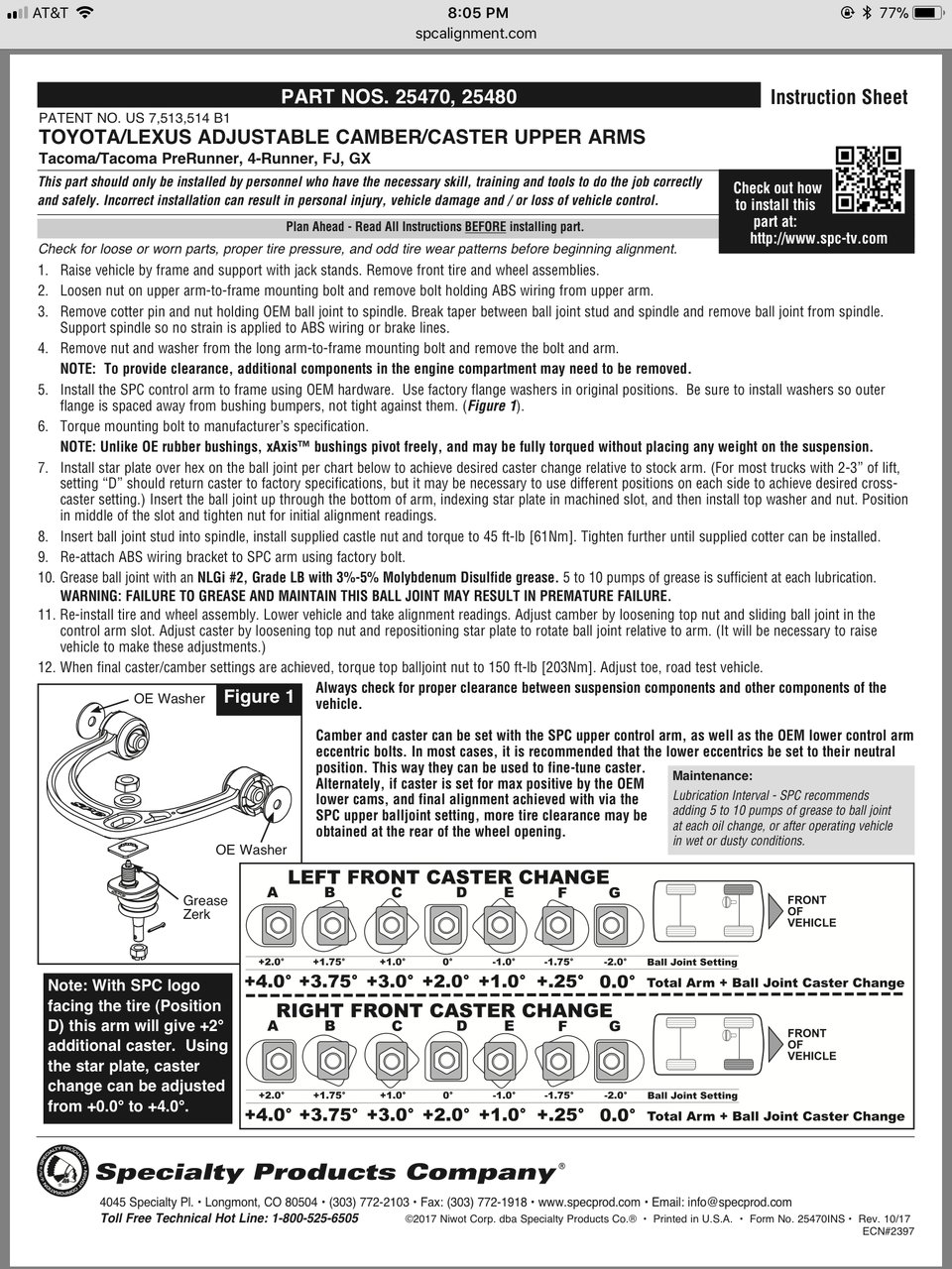

    hi
    Just put some 285/70/17 on my taco. The wheels have a -12mm offset. Trucks lifted 3in suspension, and 1in body. I also installed SPC LR UCAs. The front tires are rubbing when the turn becomes slightly sharp. I took it to a wheel shop to have it aligned, thinking that the UCAs would take care of the problem? They said they couldn’t get rid of the rubbing. I feel like they didn’t really mess with the UCAs as they should be. Does anyone know if I can fix the issue by adjusting the control arms?

    Unchained 5150 Rick

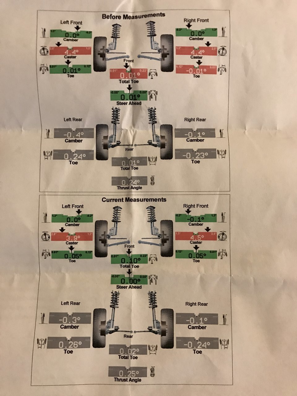

    Rick

    Most and all shops don't know that your arms have a lot of adjustability. They wont even want to touch it honestly. Get in touch with the actual person doing the alignment even bring them instructions on the arms so they can raise your caster which should will get rid of the rubbing.

    Ask if he did touch it. Most cases they wont cause they can adjust off the factory adjustments. Tacoma's are built with the alignment adjustment on the lower arm using Alignment cams that turn in and out. Getting more caster allows for better tracking and causes the arm to push the wheel in the wheel well forward. Thus gaining more clearance behind the front wheel.

    Castor moves your tire forward, at an angle.
    Ideal specs for the alignment are castor +2.5-4 0 toe 0 camber. Your instructions tell you how to adjust or add castor.

    I did mine myself on my garage floor (the "Before Measurements"). Took to alignment shop for confirmation. I didn't "pay up"!

    There's a difference (time) between throwing it on the rack for confirmation and setting up the entire front end from scratch
