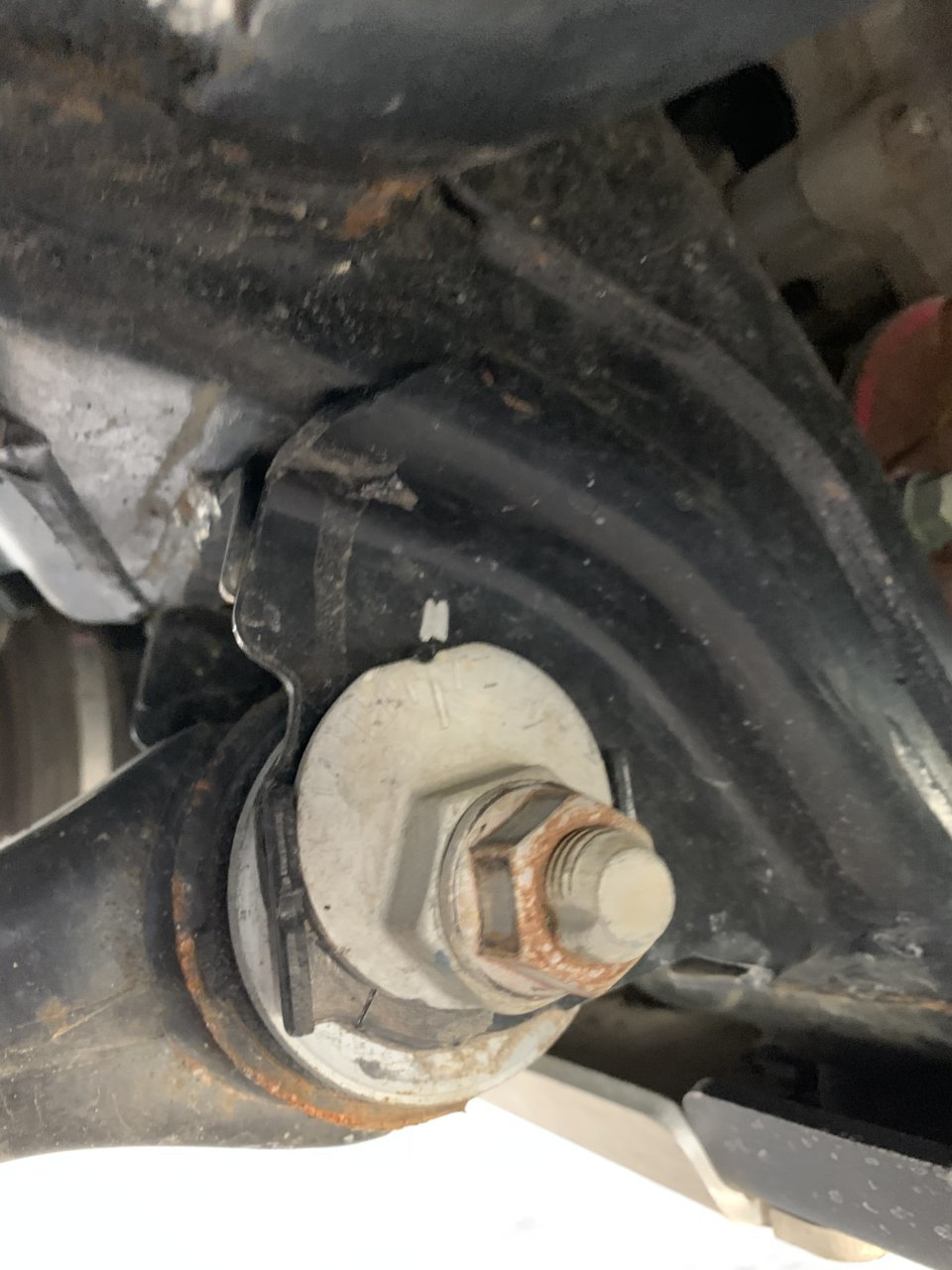

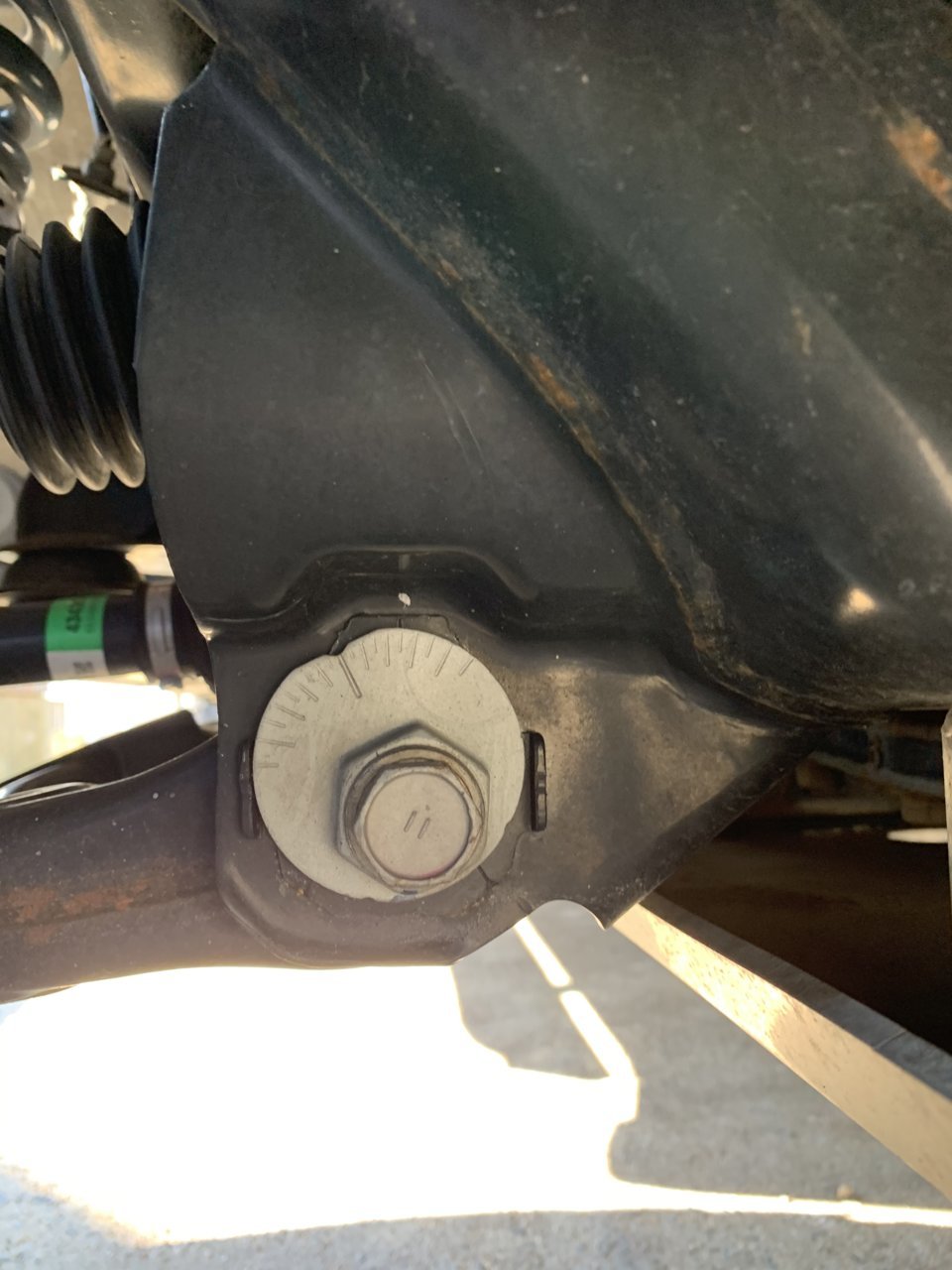

    Drivers side
    5BD9417D-F10B-4B60-9F6B-A71D933374B8.jpg F58B46EB-F9F4-424A-90D8-C60235723FEE.jpg

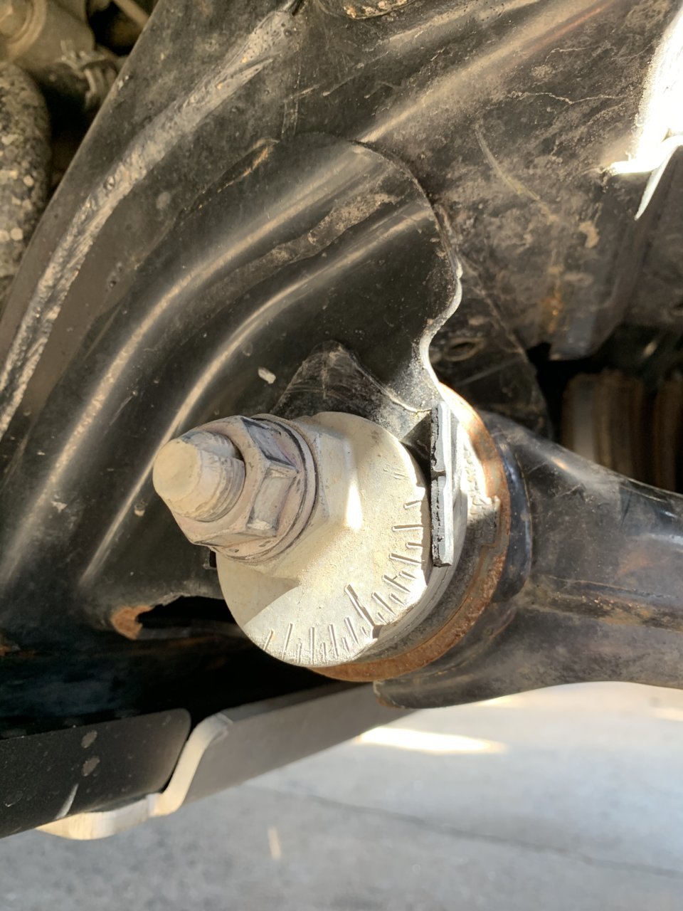

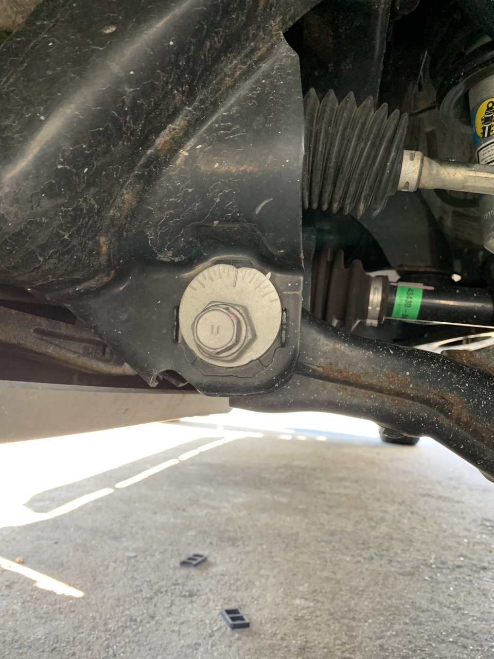

    Passenger side. Looks off doesn’t it?

    Yep. They should be mirror images of each other.

    Your passenger rear cam don’t look right. It should be around the 9 o’clock position. Get a new alignment guy.
    You cannot lower caster with the Uca that you have. Since it’s in a fixed position. The only way you can lower caster is using the cams on the LCA. Lowering caster on the LCA will push the wheels back towards the cab mount.
    When people say to lower caster to gain more clearance, they’re talking about UCA. Like spc uca. So lowering caster with the spc uca will push the top of the wheel forward, away from the cab mount. But lowering your caster also make your truck ride like shit.

    Yup like @Asianguywithatruk said in the last pic your cam tab bolt is upside down. :rofl:I had a bad shop do that to mine once and I laughed about it with the shop that fixed it when they showed me.

    the index tab is just flipped 180* it won't hurt anything. There are two grooves on the cam bolt, it can only go on two ways, and they'll both give the same result.
