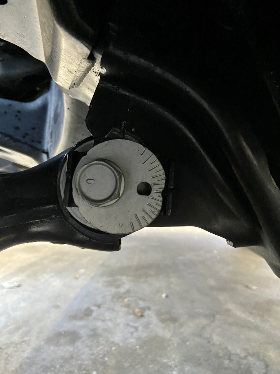

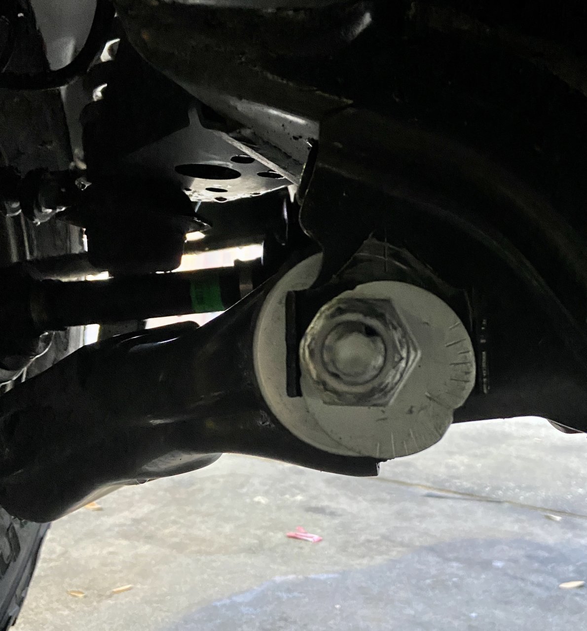

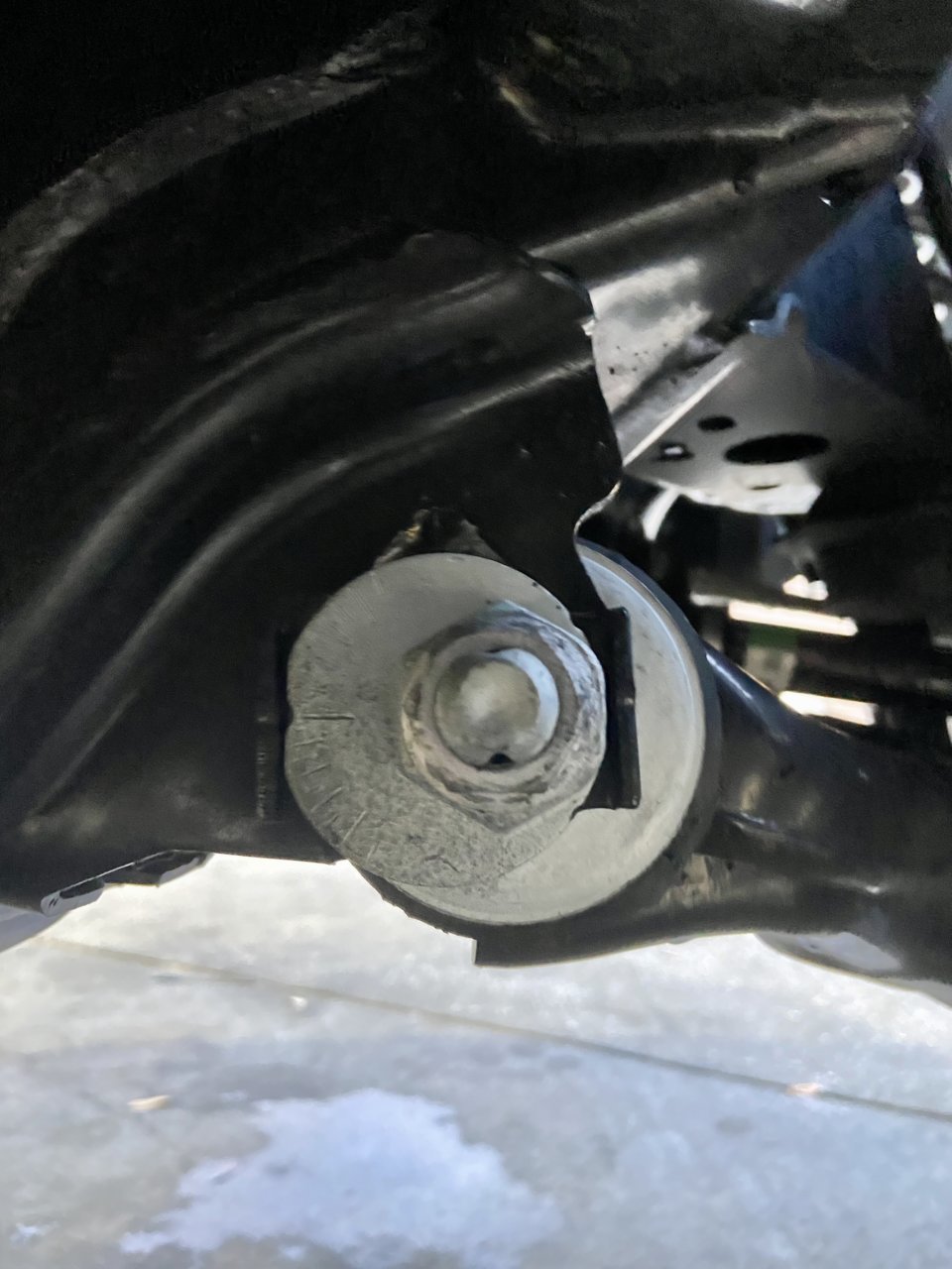

    So here are pictures of my cam adjusters.
    What I am getting is my drivers tire is rubbing on CM when I reverse AND the tires turned to the left. Absolutely no rubbing with right tire.
    I have 285/70/17 tires, Icon tubular UCAs, and Fox 2.5 coilovers netting me about 2.25” of front lift.
    Before this, I had the same tires, stock UCAs, and OME 887 springs on Bilstein 5100s netting me a hair over 2”. I have no extra weight on the truck.
    I had just over 1” of clearance BEFORE and I now have about 2mm of clearance on the drivers side between the tire and CM with the drivers tire turned to the left.
    I’m assuming I need to get another alignment.
    The alignment tech that did my service said that he couldn’t turn the camber any more positive on the drivers side, unless the vehicle will start pulling to the right.
    I really appreciate any and all help with this. Hopefully this might also help the OP and others searching for the same issues.
    DRIVERS REAR
    DRIVERS FRONT
    PASSENGER FRONT
    PASSENGER REAR
