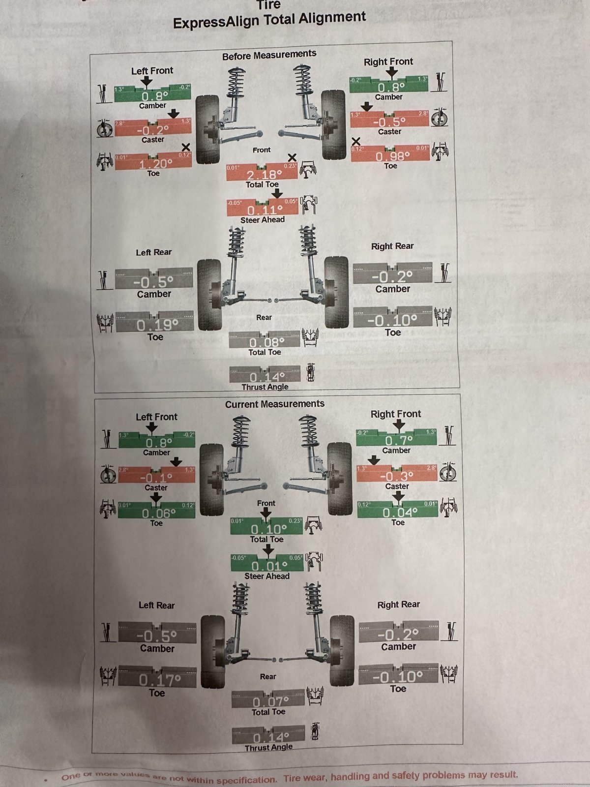

    Trust me they barely rubbed at all unless I turned all the way left or right. I wish I had pics of how little I trimmed off. I researched forever and seen everyone saying they had rubbing with 33s. But yea here’s a pic of the numbers

    Yep. Horrible. They set toe and let it go. If your on factory ucas I’d replace them. But that alignment is really bad.

    Yes.if you buy ucas that are adjustable or have built in caster it will help greatly. But you still need a good alignment guy. Some techs just don’t understand how on these trucks the caster and camber set up effect one another. With the caster #s you have the truck is gonna want to wander, bump steer is gonna be bad and the over driving characteristics just won’t be good at all.

    A good tech should be able to get you at least 1.5 caster and still keep camber in spec with factory ucas. That would help. But new ucas is definitely the way to go.

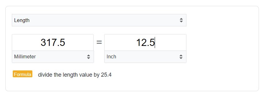

    You put ~315s on your Tacoma and are surprised you are rubbing? People talk about 285s and having to CMC so they do not rub and you're at 317.5 (12.50) and you are surprised? What wheels are you running and what is the offset?
    Edit: I don't mean to come across as a dick here so please assume positive intent.... did someone suggest to you 12.50 tires would work without issue on your Taco? Did you do any investigation into what width tires these IFS rigs could accommodate without modification? I ask because most people know exactly what they are getting into when they try to stuff 12.50s or 305+mm tires under their Taco.
