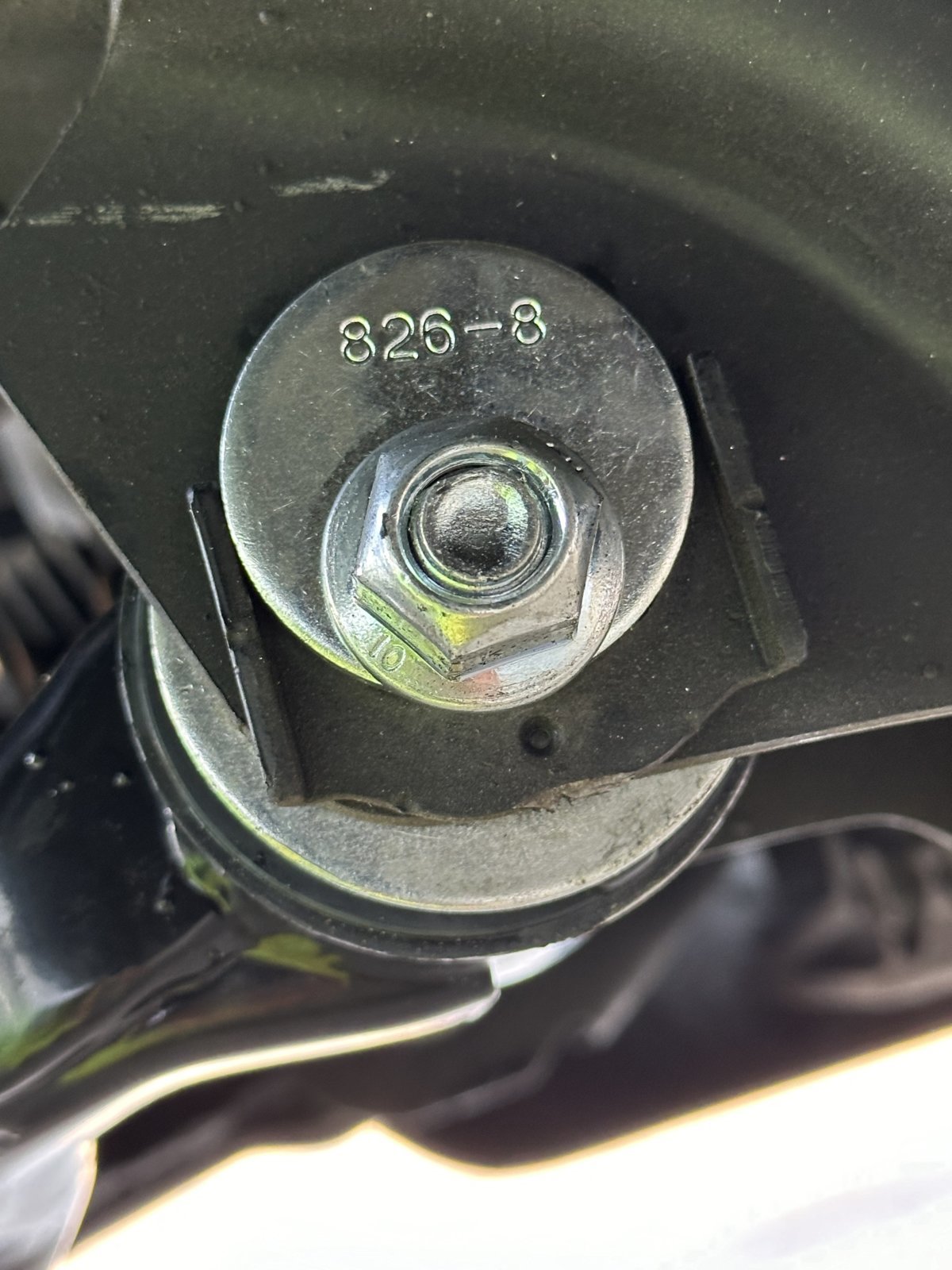

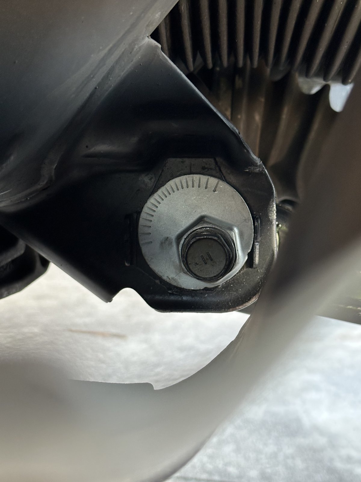

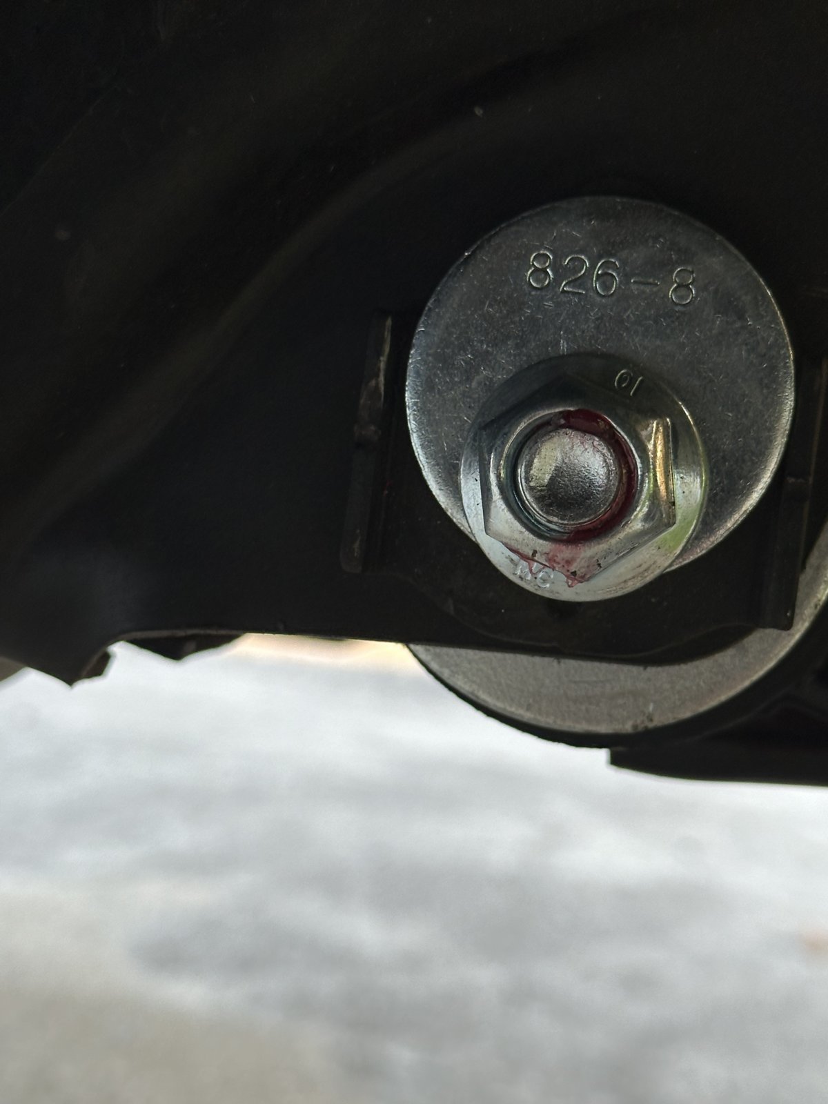

    I have stock uca’s and a the lca’s are a cheap Amazon brand so I’m
    Not sure about adjusting them but I’ll take a pic of them in a min
  13. Jan 29, 2024 at 1:58 PM
    #33
    Jayaye910
    Jayaye910 [OP] Active Member
    Feb 23, 2023
    #418653
    44
    So these are the pics of the lca cams and they look like they haven’t been touched since I put them on. One of them still has the grease on it so there’s no way they put a wrench on it

    Shoot for 3+ on the caster...0-0-3 are the targets for the alignment tech.

    Definitely getting uca’s. I still think adjusting the lca’s will help. I literally installed them and rolled the cams until the numbers were straight up. Torqued the bolts and drove it to the alignment shop under the assumption they would adjust them right

    Yes, they'll need to adjust the LCA to get those numbers.
