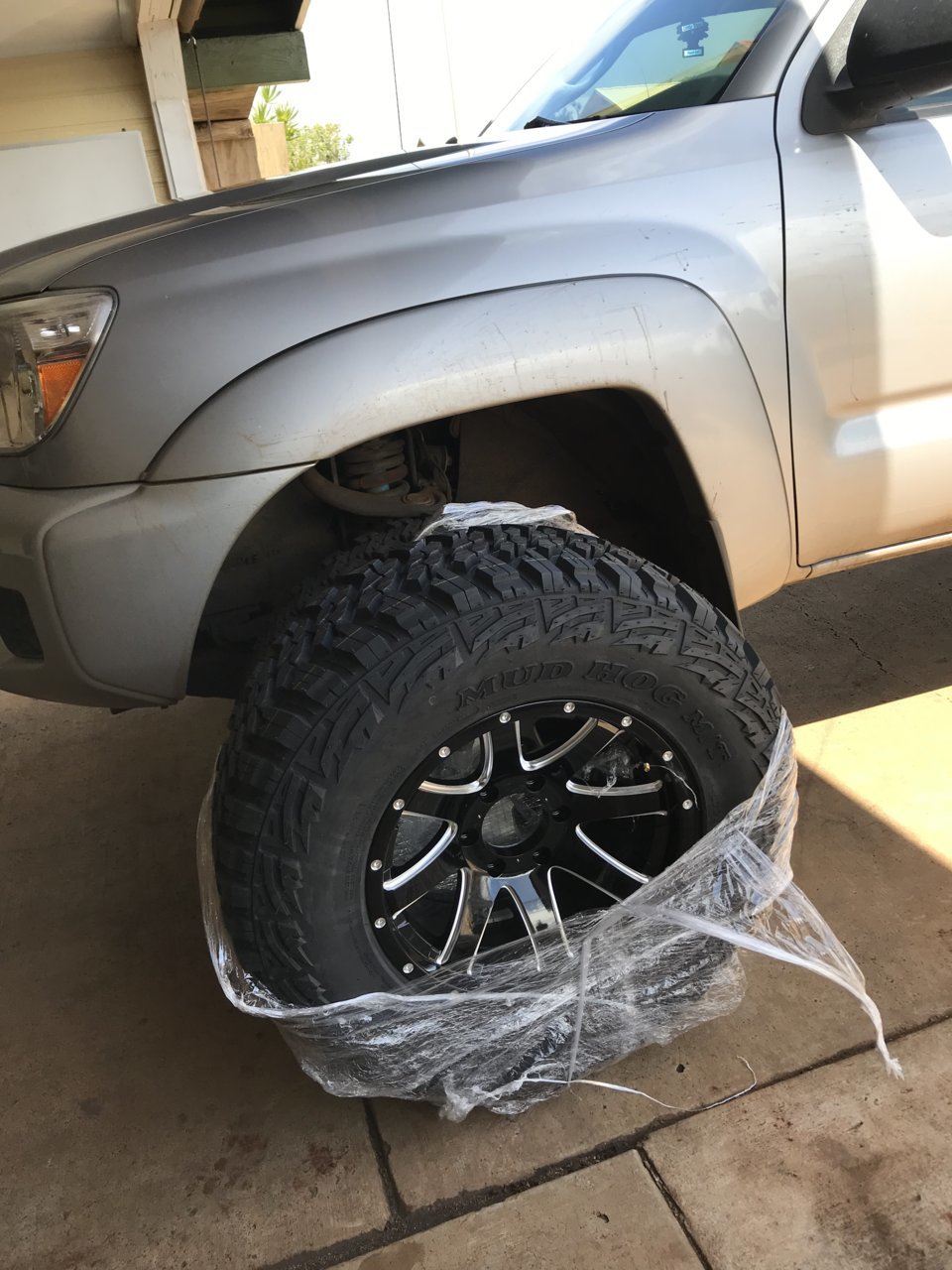

    Any of u running 285/70 R17 with 3” front level and 2” rear blocks? Do u guys have to minor trim on fender or nah?

    Thats with a 3” front level kit with 1 1/2 wheel spacers (new tires and rims is not on, just a side view only)47D4F29A-EAD9-4C98-B007-3325E2F083A5.jpg

    Depends on your wheels and tire specs, plus alignment and how much weight you have on your truck.
    Normally, to fit 285's, at a minimum, you'll have to remove the front mud flaps. Also, most people have to cut small slivers of plastic fender within the wheel well. If that isn't enough, recommend CMC and hammer in or out the pinch weld.
    I would also like to caution you of the potential of your wheels/tires rubbing on your UCA's.
    Lastly, you're in for a rough ride with blocks. Have you considered Bilstein 5100's all the way around? What are your plans for your truck (what do you use your truck for)?

    Thats for the reply, yea, rim has a backspace of -5.00 and im using the stock shocks,, I understand that i will have a rough ride,, im also running on 265 - 75 R16 right now,,
    Im using it for daily driven and a little of offroad (hunting) no major offroading

    Better to save up money to buy suspension lift than waste money on spacers and blocks. But, it's your money...your truck...I take no responsibility for any decisions you make or possible damages you may cause. LOL.
