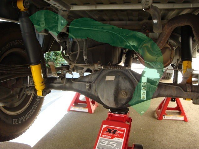

    These trucks had a brake proportioning valve on the rear axle. As payload increases in the bed and it is weighed down, it pushes on a lever that increases rear brake pressure so the front brakes aren't doing all the work. If that valve or lever mechanism is not functioning and stuck in the down/ loaded position, the could be the issue.
    I've highlighted the bracket and lever on the rear axle, which has a long connecting rod up to the brake proportioning valve near the upper left frame rail. The valve body itself may be faulty, or the rod may not be connected or may be bent/damaged.
