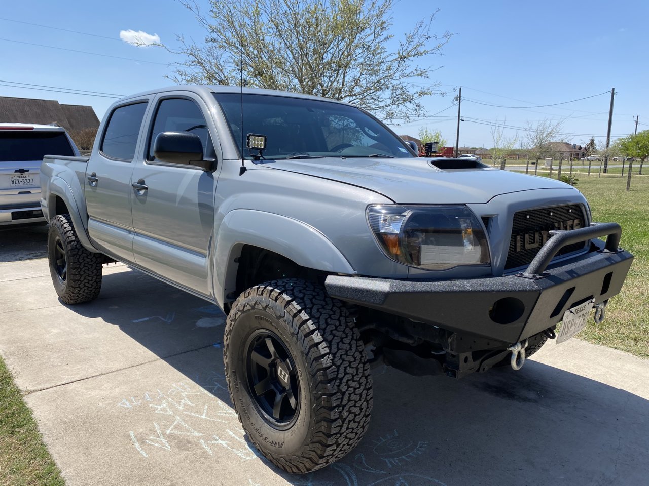

    I was running LT285/75r16 on my 2008 with a 2 1/2 inch lift. I had to do a cmc.

    The 33s will rub the uca on a factory offset wheel. You’ll need a cmc more than likely and a good alignment. If you do any decent kind of wheeling they’re gonna rub.
