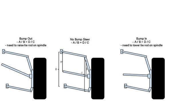

    Can you post a picture of your uca, lca and tie rod from the front?

    #398840
    13
    Jose
    2017 Tacoma TRD
    this is the pictures.

    7,858
    NW Arkansas
    2016 TRD OFFROAD DCSB MGM
    The upper control arm geometry looks fucked up. Should be closer to parallel with the tie rod and lca.

    13
    Jose
    2017 Tacoma TRD
    Are you think my steering knuckle is too high?
    This tire are 295/70/18

    534
    North Carolina
    2017 Tacoma TRD Off-Road
    See Profile for a full list of Modifications: *Suspension* -Total Chaos Upper Control Arms -Total Chaos Lower Control Arms -Rock Rash performace welded spindle gussets -King EXT Coilovers with adjusters (front) -King Tundra EXT Shock with adjusters (rear) -Icon RXT leaf pack (Option 2) -Timbren active off-road bump stops (front) -Timbren active off-road bump stops with U bolt flip kit (rear) -DRT cab mount relocation -DRT Shackle hangers with DRT cross member -Dobsins front leaf greasable bolts -Polyurethane front body mounts *Performance* -AFE intake (noisemaker) -JLT oil catch can -OTT Tune -Stoptech stainless steel brake lines -Power Brake D-Line kit -Extended stainless steel rear brake lines -AGM Odyssey battery -Tacoma TRD Pro Exhaust *Interior* -Window Tint -Tacoma Door Sill Protectors -Clazzio (black leather seat covers) -Dashtop Single Mount -Sound deadening material -GATOR floor mats -Cup holder hero mats -Garmin mini front dash cam -JOYING Headunit -Tacoma Kicker tweeter upgrade -Kicker KS front and rear speakers -Rear USB -Meso Customs interior lights *Exterior* -Tacoma tailgate inserts -Mobtown offroad "No drill" Bolt-on rock sliders. -All-Pro Hi-Lift bed rail mount /w Hi-Lift -Rear Diff breather relocated -Alpha REX TRD Pro style headlights -Baja Design squadron sport (Amber fog lights) -Total Chaos Fabrication bed stiffeners -Window Deflectors (AVS) -TRD Pro Grille -Summit DAKAR (BRONZE) -Toyo Open Country R/T Trail (35x12.50 R17) -Sequential turn signals -Softtopper (black) -Toyota Bed Mat -Vinyl wrapped tail gate (black) -C4 high clearance fender liners -C4 High clearance Rock Runner rear bumper w/ Baja Designs S1
    The only thing I can really see that may stand out is it looks like you still have stock Upper Control Arms. My guess is during a dip you have no more up travel and it bending the spindle outward. I'm also wondering how much travel you have in those Fox's since you have a 5+ lift.
