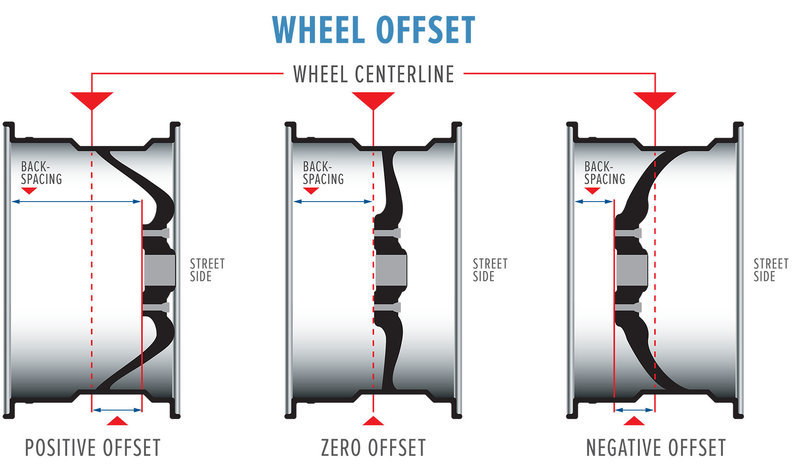

    You should be ok at 0 offset. The stock rims are +30. That means the wheel is rims outer lip is pushed in. + Means in - means out. Take a string and tape it to your fender. Let it hang straight down on the center of your rim. Now measure from the string to the lip of the rim. A 0 offset wheel will be 30 mm closer to the string.

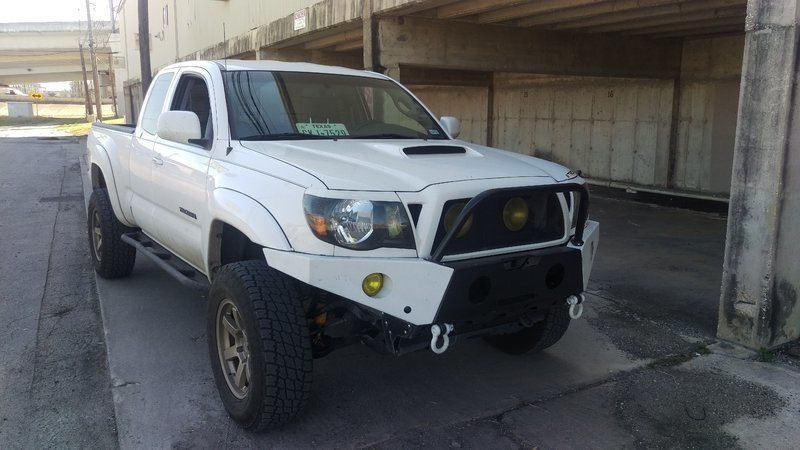

    Spacers will get you what you want but two inches is quite a bit actually, mine are probably at an inch and it gets dirty real quick due to dirt and debris being picked up and thrown around by the tires. IMAG1146.jpg
    But it is a truck so I really don't mind it getting dirty.
