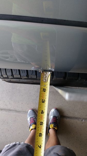

    -12 on what width rim?
    Helps to know that value :D

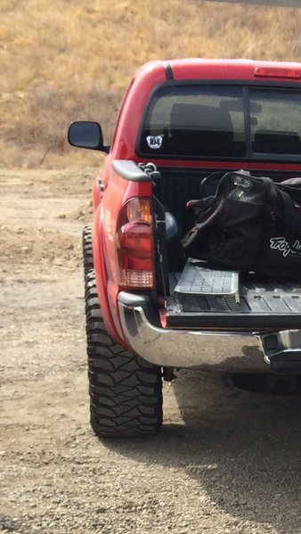

    Red Dirt Road 17/9/-12 4.5 bs14931461908181744103391.jpg
    lynyrd3 and shieldze1025[QUOTED] like this.

    5,673
    AZ
    2nd Gen Double cab Pre Runner
    What mud flaps
    lynyrd3 likes this.
  11. Apr 25, 2017 at 11:52 AM
    #51
    nudavinci64
    nudavinci64 Robert @ Holy Horsepower
    Nov 14, 2013
    #116533
    10,145
    Robert
    San Mateo/Cayucos, CA
    13 S/C TRD OffRoad 4x4
    Boosted Money Pit....
    They stick out but not sure I would say 2". Maybe in the rear not the front. Running the same setup. Now I have to go check and see how much. :boink:

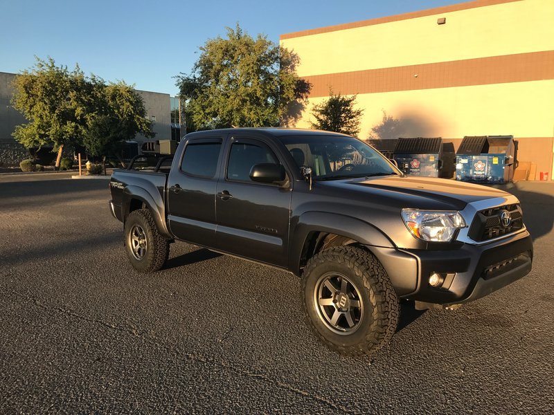

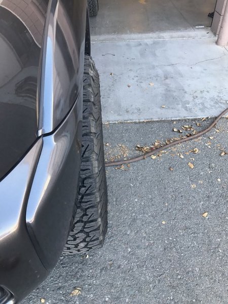

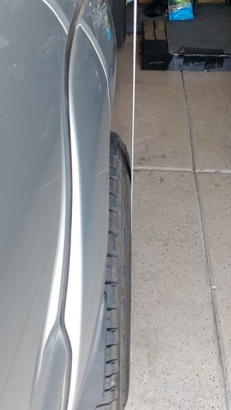

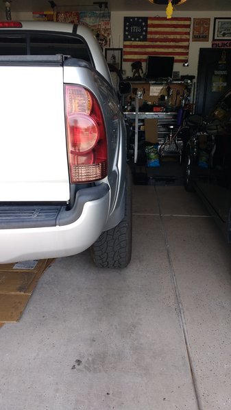

    -12 offset on 17X8 wheel. Tires are 275/70/17
    lynyrd3 likes this.

    Do you have a lift?
  18. Apr 25, 2017 at 2:03 PM
    #58
    2015yota
    2015yota [OP] Member
    Feb 18, 2016
    #178555
    20
    Your picture did not upload
