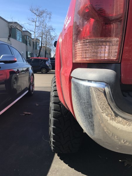

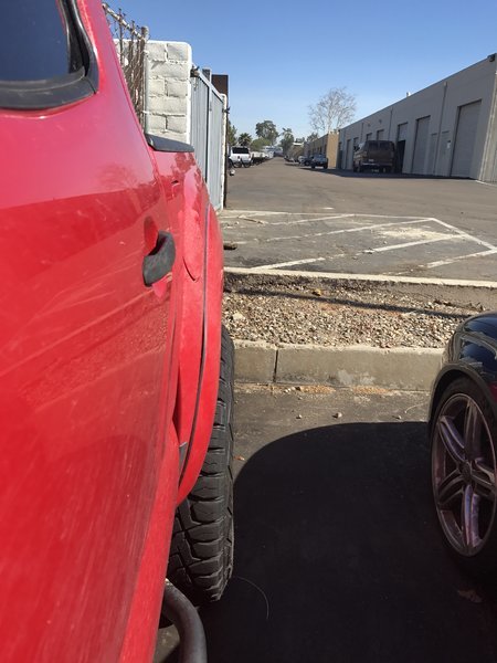

    Those are 33" x 12.50" x 17", same width as a 35, but not as tall.
    This was 17x9 -12mm offset and 285/70-17, just not quite as good of a side view

    At the time that picture was taken I had bilstein 5100s set at 0 and maxtrac spindles yielding 3.5-4" of lift. The rear was stock. Yes there was rubbing, a lot of it. Had the fender liner trimmed and a little bit of the fender, had I known about the CMC i would have done that because I rubbed there too. The rear had no issues.
    Wheels are XD Series 796 Revolvers.
    The picture below, with 285 tires was only bilstein 5100 at 2.5", didn't have the CMC done only the fenders trimmed, but CMC would have helped.
