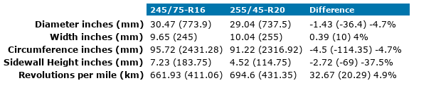

    the tacoma i own is a 2006 4 cylinder, access cab 2x4. i seem to have an average of 18.5 and thats if i baaaby it. i keep everything under 2000 rpm's pretty much no matter what. the truck came with 20 inch rims. "255/45/20" i was wondering if that is enough to keep me away from the 21-22 i would really like to achieve, i drive almost all highway. i havnt done any mods from the mpg thread 2nd filter ect ect. thanks - Brandon

    yes, so are big tires, and rolling those with the 4 cyl = worse gas mileage

    true that, ive seen members on here with all terain tires and smaller rims achieve better mpg then i. maybe its a weight thing to, didnt thing about that

    from the online tire size calculator
    the diameter and circumference of the wheel are lower correct? so that rules out the bigger tire issue. " forgive me if im wrong, if i knew this stuff i wouldnt make a thread about it" so is it just the weight of the rims?

    thats what i was looking for, my gf's father and i played with numbers today and figured that out. this solidifies it. thanks. i almost always have the a/c cold that doesnt help either haha

    i knew that it was causing the problem, thats the whole point of the thread haha . i dont think my truck was reprogrammed for the new tire size, causing the odometer to show slightly less miles driven due to the bigger size tire. " moving further with less rotation"

    You could have close to the same circumference as the stock tires with a 20 inch rim. You would need to run a 255/35R20. This would get you very close the stock tire.

    I agree. I was just saying it CAN be done on a 20 inch rim.

    The difference that is the biggest cause of the milage being so low is the weight and rolling resistance of the wheels and tires.
    Just for fun take the spare off if it is stock size weigh it and weigh one of the 20" set ups.
    Moving heavy wheels and tires eats up gas milage.

    Yeah it's not just the weight of the heavier wheels making it a heavier truck overall, it's also getting the extra wheel weight spinning... bad fuel economy and more brake wear too, just a bad deal. The stock steelies are no lightweights, but many of the custom street setups are particularly bad in every way except cosmetic appearance and maybe cornering grip. I won't even get into the additional unsprung mass.
