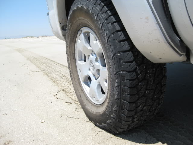

    Having driven deep beach and desert arroyo sand for many years I can advise that street or all terrain tires are easier to use than mud tires (less tread is best). The reason is you want to float on top of sand, not dig into it.
    3 ply sidewall tires also do not float as well as 2 ply... I have driven All Terrain TAs in sand, and it is less float-able.
    If a mud tire or a 3 ply sidewall tire is what you got, then it will just require letting more air out to float as well.
    Rugged Trail TAs, Toyo Open Country ATs, Cooper Discoverer ATRs, Pep Boys Dakota ATs, Hankook Dynapro ATms all do well in sand at 15-20 psi.
    All Terrain TAs, Cooper Discoverer STTs need to be at 10 psi or under to float as well.
    The same sand will change throughout the year based on temperature and humidity. In the winter, I can drive the dry beach sand at full pressure (38 psi Hankooks, 32 psi Rugged Trails), but come back in the summer, and I will need to deflate 50% to float.
    Now, here is on New Years Day weekend 2012 in Baja... I was able to drive over the dry sand down to the low tide zone (wet sand)... but the beach is made of small shells and it is hard to float on that...
    The beach is steep as well, so you see 4 seperate track as the truck drifts sideways a bit while trying to drive straight (38 psi).
    Once I take 50% of the air out (to 19 psi), the truck immediately floats on the wet, shell filled sand...
    Here see that my foot prints sink deeper in the sand than do my Tacoma tires once deflated (dry sand):
    A couple of photo from last July in Baja...
