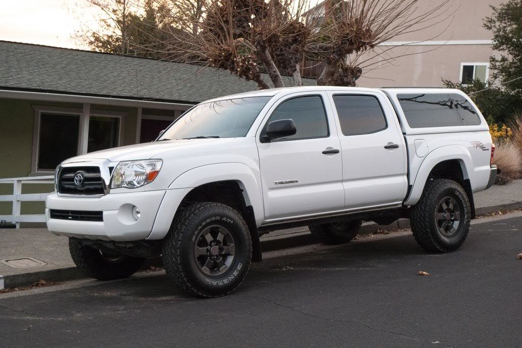

    SnugTop SuperSport SpiderTrax 1.25" Spacers BAMF Sliders OEM smoked headlamps Pro Grille Paint matched grille surround Tepui RTT
    Here is my truck the day I had 285s installed. They don't reall stick out at all. Had 265s on before and they didn't stick out either.
