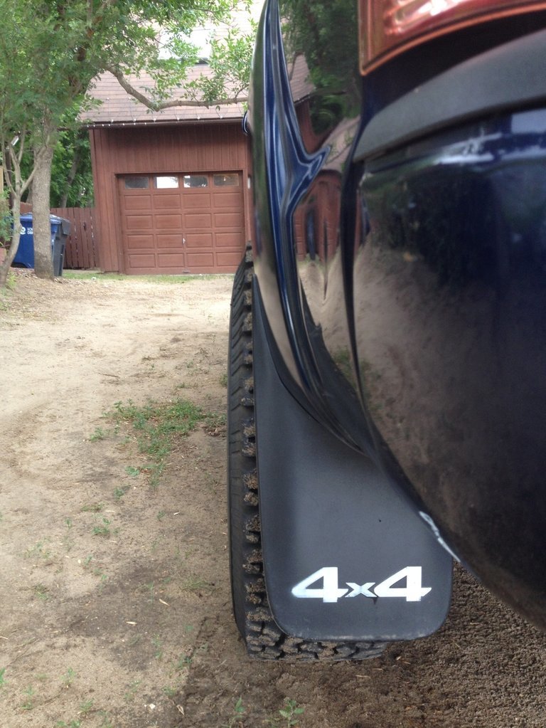

    Just remove you front mud flaps and you might need to trim a bit of the front and rear fender depending on I believe it's the degree of camber. What's the offset on the rims? My rims are -12mm offset and 4.5 backspacing which keeps my tires from contacting the UCA's, otherwise you'd want at least 1/4" wheel spacers.

    Umm do they stick out past your fenders at all? Mine stick out this much:
