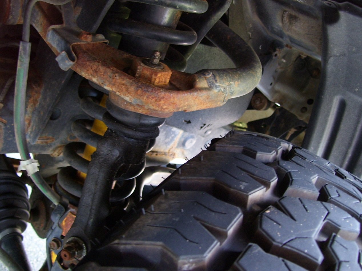

    If you have a +12 offset wheel I'd be more concerned with rubbing on the UCA at full lock. Not so much at the spindle.

    Total Chaos have more clearance. I run 34" tires and used to have JBAs. The tires rubbed against them at full lock so I switched to Total Chaos and now they don't rub. Something about their design allows more more articulation and more room for turning with larger tires.

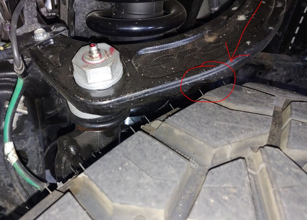

    What position are your SPC UCA's installed at? It almost looks like they don't match from side to side? It looks like they are around A or B, you could change them to D and it might give more clearance. I run mine at E and with 305/65/17 on 17x8.5 with -10 offset I have a bit more room.

    They're both on the D setting, it's just the front of the truck is one side in the first photo and the other side on the 2nd. At least that's what I make of it
    The ball joint setting won't affect how close the wheel is to the UCA, but its position in the camber slot would. But it looks like it's set up correctly from what I can tell

    You should be fine, that looks like the same amount of clearance I have. Is your truck on a lift or jacked up in the pictures?

    nah just sitting in the parking lot and waiting for the next adventure

    It's the +12 offset that's putting the tires so close. If you start to rub you can adjust the ball joint all the way outwards and have it realigned. The alignment tech will have to adjust the camber at the LCA.
