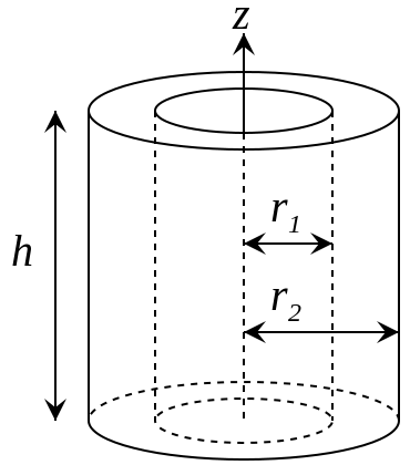

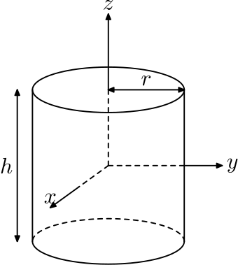

    VS.

    paradoxically, lol math reaches a point where it looks more like "English" than it does anything else.
    WHAT R ALL THOSE LETTERS
    SOLIDS VS HOLLOWSSS
