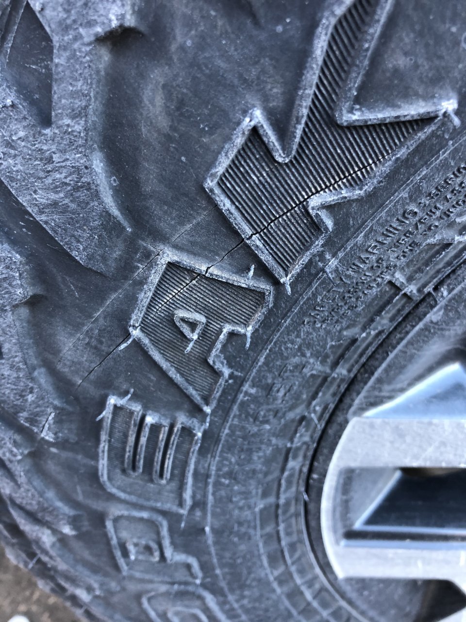

    I’m part of the wild peak fan club here ( 265 75 R16 AT3 W Eload). Had them out twice and they took a beating. Glad they are E load.D1A17C3A-9249-418A-8157-9D5426DF1042.jpg
    that’s just 1 tire I could go around and take more photos of less obvious damage. But I like to think if I had a thinner tire she’d be gone. Other than that though they handled everything I could throw at them on a very wide variety of terrains

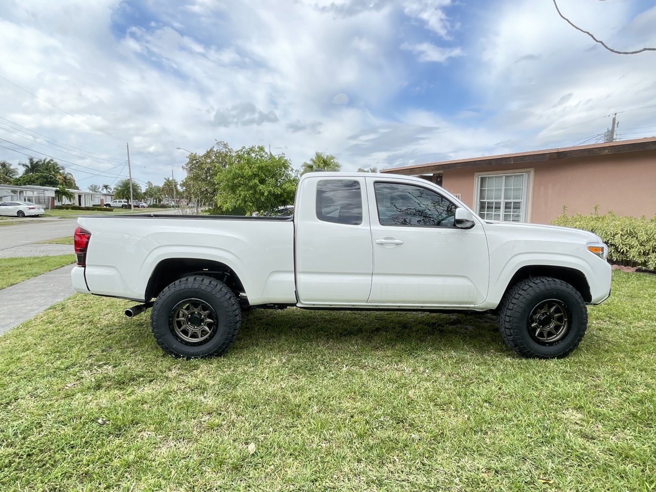

    I did it guys ! 265/75R16 E rated ! Look incredible.
