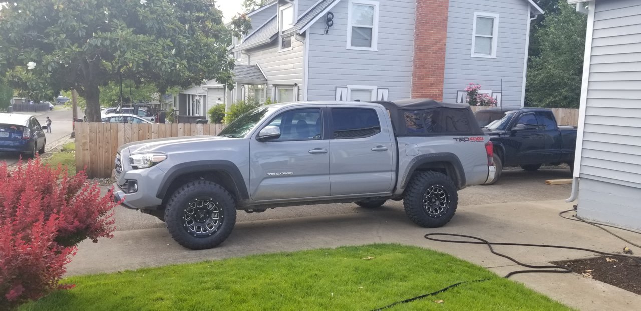

    2019 Tacoma OR 4D 4WD SB. Truck is completely stock as of right now. I know this topic has been beat to death, but if someone wants to answer a few simple questions it would be much appreciated. Looking to do 17x9 wheels with the largest tires possible without cutting. The wheels I am looking at are the Pro Comp 40 series Vertigo:
    17x9
    offset: -6
    backspace: 4.75
    Will these work? Also, what do you think I can get away with as far as tire size goes with these wheels? I am open to suggestions on a different size wheel / tire combo. Thanks.

    *Update*
    265 70 r17 tires fit with no rubbing on the wheels posted in the original post. No modifications needed. 20190611_174712.jpg

    Looks great! Wheels and tires only?

    Lift? Is that a besttop or soft topper?

    No lift. Completely stock other than wheels and tires. The topper is a Bestop Supertop.
