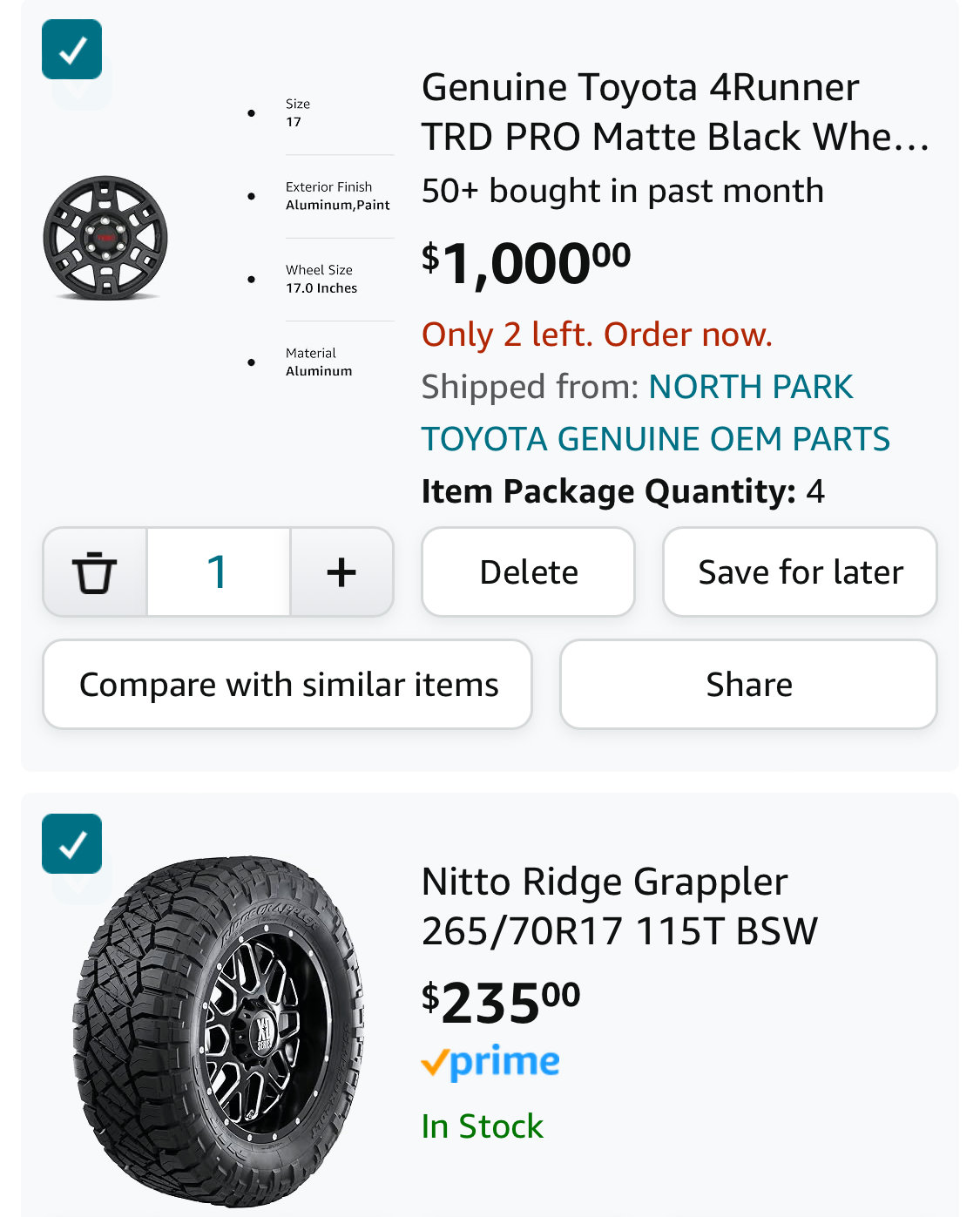

    Can anyone verify this?
    “The largest tire for stock a 3rd Gen Toyota Tacoma suspension is 265/7516 or 265/7017. Many guys have verified that these tires work with no rubbing whatsoever on our stock suspension.“
    -Toyota Technician (noticeably new on the job). I thought I could go slightly larger without any modifications... Anyway, if this is the case then the attached would be perfectly suitable for my vehicle without having to mod, tune etc. correct?

    2019 Off Road Looooooooong Bed
    No issues going from 16 to 17 inches.
    I would double check if those 4R wheels will bolt up to your Tacoma. I’ve seen several posts on here starting that the new 4R wheels no longer fit our tacomas.

    2021 MGM TRD On-Road DCSB MT
    RC60F Transmission ADD delete with FJ full-time tube FJ Metal Clutch Pedal OEM Mexico-Spec Condenser Fan 265/70R16 Michelin Defender LTX M/S 2 OEM 1-Piece Lug Nuts Custom Built Switch Panel for all Electrical Accessories Rigid Amber Pro D-SS Ditch Lights Rigid 30" SAE High Beam Driving Light Bar Rigid SR-Q Pro Back-Up Light Kit (Recessed) VLEDS Tail Conversion VLEDS Foot Well Light Kit KC HiLites Cyclone V2 Under Hood Lights Operable (Switched) Clutch Safety Bypass
    The ones she’s looking at are Semas and fit fine. The 2021 4R TRD Pro wheels are the ones with fitment issues, and they look slightly different.

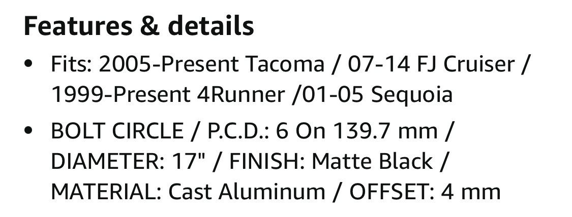

    ‘23 TRD OFF ROAD SILVER
    This is from the listing. You think it may be inaccurate?

    #439226
    260
    Michigan, USA
    2022 Tacoma SR utility package
    Not sure about the 4mm offset but I'm sure you will be better than -4. I did a lot of rsearch before pulling the trigger on such a large purchase, looked through about 150 pages on this forum for "Aftermarket wheels and tires on stock 3rd gens NO LIFT" and other threads like it. I changed my stock 16" steelies out on my base model SR to 17" Method wheels, 17x8.5 +0, with 265/70/17 tires. Perfect fit, no rub at all and sits perfectly flush to the fenders, maybe a hair of poke due to the aggressive tires I picked. If you have factory mudflaps, you may have to remove them. My truck didn't have any mudflaps, and I removed my air dam from the front bumper.
    Also, im going to get an alignment done later today, you should if you upgrade to such a bigger different size tire, some people say don't, but im going to just to be safe.
    Aside from the “more attractive wheel” I’m doing it for a slightly more aggressive stance. These wheels are 17x7 however. So, I’m hoping with that Nitto I’ll gain some neg. Luckily I don’t have to worry about air dam, doesn’t have one. Muds, yes. Thanks for your comments.
