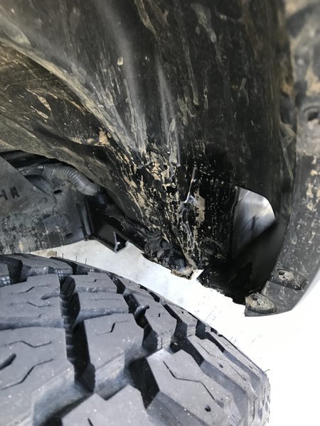

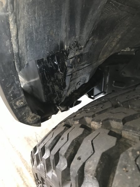

    You're gonna have to do some serious trimming to get a 285/75/16 to fit, I think the closest version of that to a 17 tire is within .1 inches and it's a 285/70/17 if you really do have 17's but that would mean they gave you the sport tires. The sport tires have more backspacing which means that a 285/70/17 is gonna be rubbing on your uca's if you put it on their without going to aftermarket uca's or getting new wheels with 4.5" backspacing at 0 offset. The sport rims will not fit a 285, if you want a true 33 though and don't want new uca's or new rims then a 255/80/17 is gonna be your best bet. It's up to you but you won't be able to fit 285's stock on sport rims without rubbing uca's

    I guess I should have asked if he planned to off-road, if he's off-roading trimming is more serious. I'm running total Chaos uca's and 4.5" backspacing on an icon stage 2 at preset lift and I still had to trim mine hard

    That's a cab mount chop, pinch weld is hammered in, and the picture doesn't show it but that's almost a quarter of my inner fenderwell
