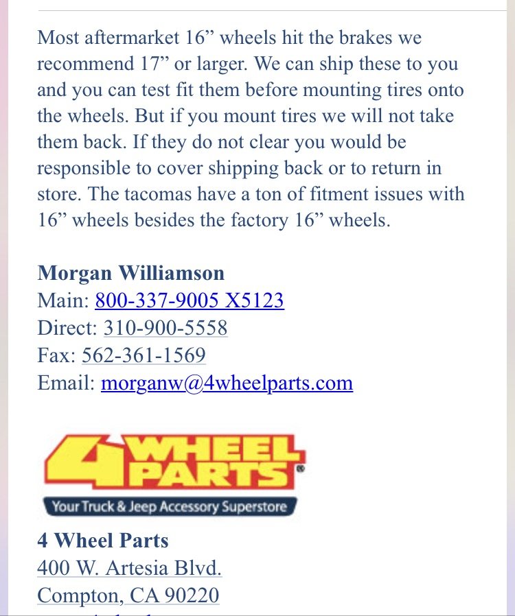

    Some do, some don't; it's about caliper clearance with the spokes.

    Seems to me if they don't fit perhaps someone misrepresented the measurements?

    You can't determine it from the measurements.

    I just kinda don't know where to go from here

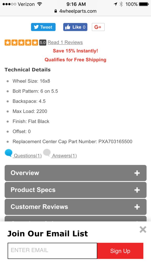

    Well tell us what kind of wheels they are and we'll tell you if they fit or not, if we know.

    That's a pretty general statement. I have 16" aftermarket wheels no fit or rub issues

    According to our measurements, the 16x8 ET0 ProComp 7031 clears your 13 brakes without modification. Let us know if we can help you with a set, we currently do not stock this wheel, but we can order it :thumbsup:
    For reference, below you will find all the 16x8 0 ffset wheels DTD offers that are guaranteed to clear the O.E. brakes.
